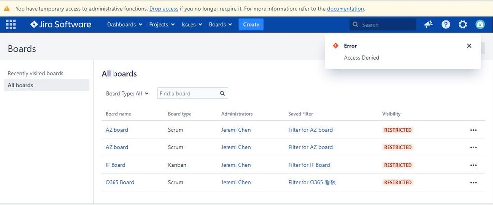

Hi
i  use jira administrator account , when i delete board, it shows Access Denied

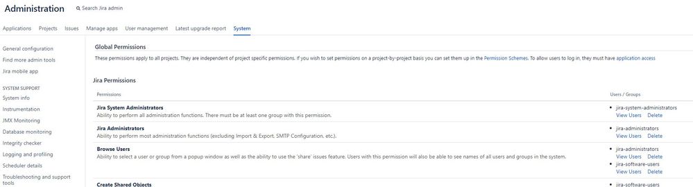

Hi @Jeremi Chen
according to https://confluence.atlassian.com/adminjiraserver/managing-global-permissions-938847142.html#Managingglobalpermissions-%23separatingadminpermissionsSeparatingJiraSystemAdministratorsfromJiraAdministratorsindefaultJirainstallations
could you please post a screenshot of your "Global permissions" page?
I suspect the account in question being part of "Jira Administrators" permission but NOT the "Jira System Administrators" permission.
Could you please double check and let us know if this is the cause?

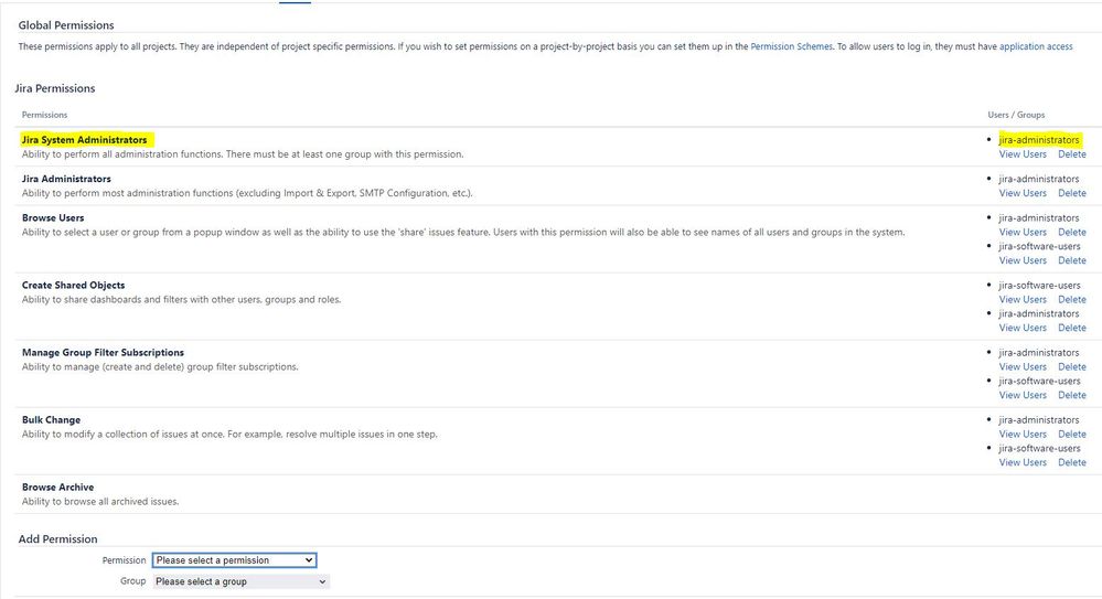

Jeremi Chen
January 17, 2021
Hi @Daniel Ebers
Thanks for help
I tried to use your URL method will still not be able to delete
Jeremi Chen
January 17, 2021
Like sudarshan likes this
Daniel Ebers
January 17, 2021
This looks pretty good and should not be a problem then.

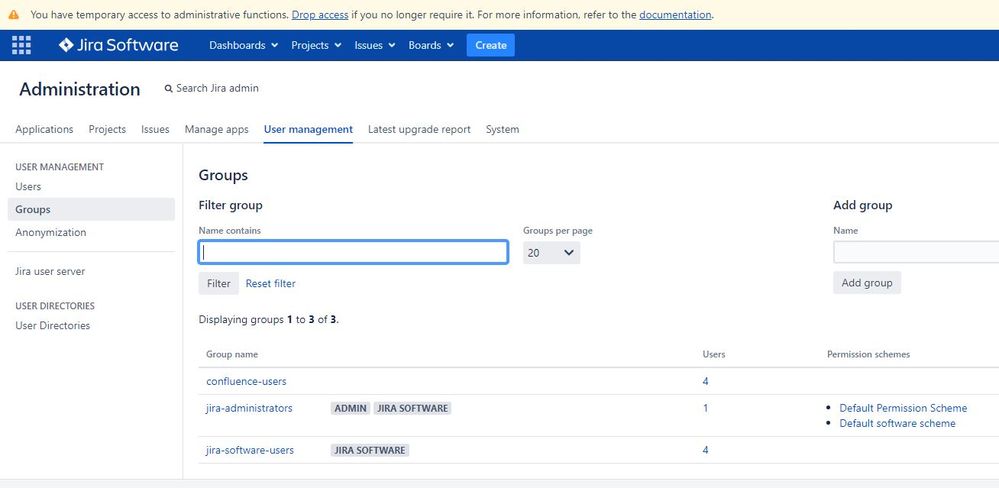

but In the Jira system i did not find JIRA System Administrators group
in the Project permissions i add administrator to all , i still delete fail

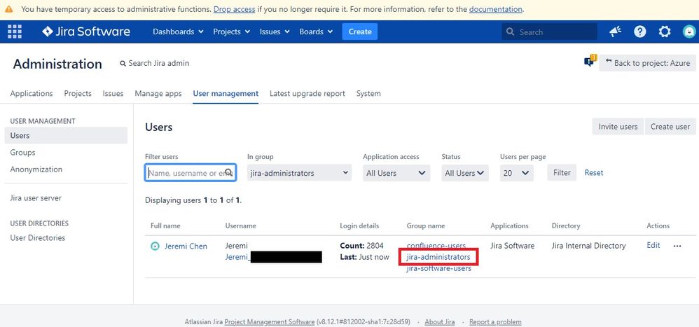

The board which you are trying to delete is restricted to you also.?
Jeremi Chen
January 18, 2021

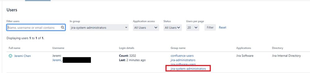

The reason is that I lack the permission of jira system administrators
I can delete it after I adjust the permissions
