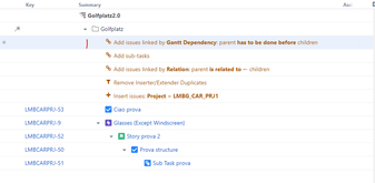

I tried to follow your suggestion but I can't realized the final step (automatic create the dependencies link in the structure).
That's what I did:
- in a sub-task I created the "has to be done before" link with another TaskJIRA1.PNG
- in the Structure I selected the Automation "Gantt Dependency: parent has to be done before children" but I'm not sure is the right one because there's Parent-Child link between the tasks
- As results, of course, no dependencies links are created in the Gantt chart
Where is the mistake?
Thank you again for the support.
Amedeo

Hi Amedeo,
This looks correct to me.  The one thing that might cause this to not work is if the extender is not set to the correct levels.  The default is all levels up to 10, but if it was set to levels 1-2, it wold not show the relationship as the linked sub task is on level 4.
If that does not solve the problem, please reach out to our support team at support@almworks.com
