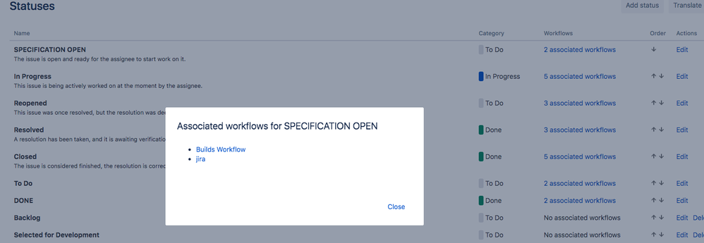

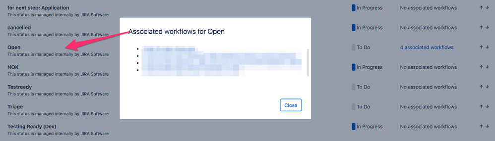

Associated_workflows_for_SPECIFICATION_OPEN_-_Jira.pngAssociated_workflows_for_Open_-_Jira_nwe.png
Anida Softic
May 17, 2019
This is how it looks under Issues/Statuses. Only one workflow is active ( the one with Open Status within).

Anida Softic
May 17, 2019
The problem is that I m blocked to rename "Spec open" to Open again as I have already that name for Status by JIRA default. And I m not able to delete "spec status" as Default Jira workflow took it and i can not edit it :/
Yes, It seems that I ll have to leave it as it is, and just make other workflows and activate them.
