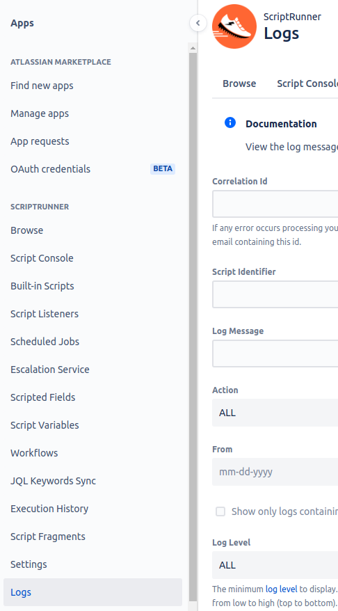

Hi @Jeanne Howe I checked the documentation (https://scriptrunner-docs.connect.adaptavist.com/jiracloud/logs.html) and it looks like there is Logs screen in the script runner:
You can log messages in your script using following methods:
  • logger.trace
  • logger.debug
  • logger.info
  • logger.warn
  • logger.error
