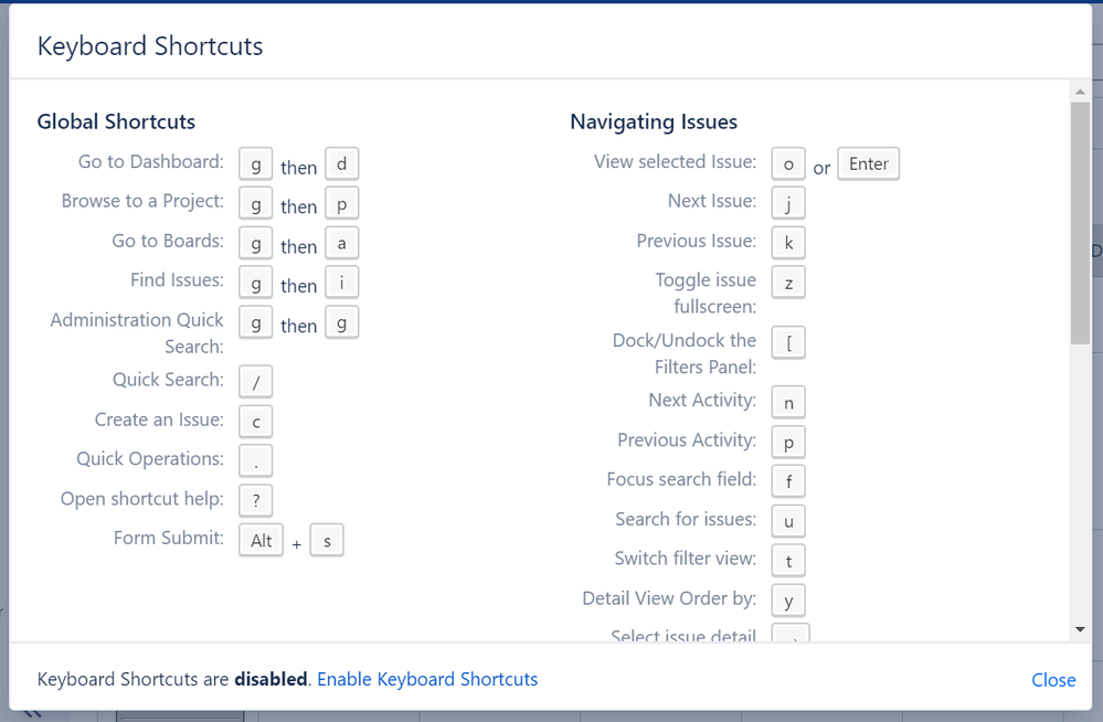

I'm writing a plugin which renderes a table on a new page on Jira. When I'm trying to edit the table (through contenteditable = "true" inside html) the Jira shortcuts are getting activated and I cannot deactivate or block them.
I already tried to just deactivate them on ? -> Keyboard Shortcuts as shown here
but now I just cannot type these letters. For example, before I deactivated them when I wrote "abc" Jira changed from Fast- to Dev-Mode (cause of "b") and opened the window to create an issue (because of "c").
