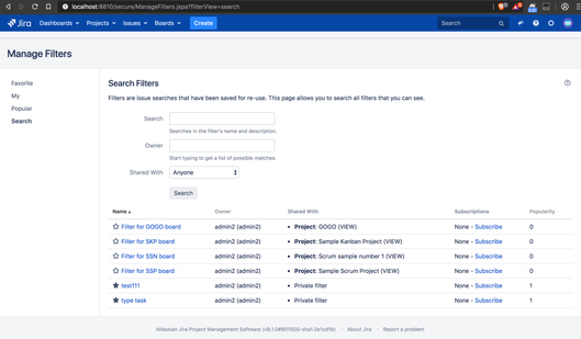

To address the first concern, it sounds like you probably have a subscription in Jira setup to send you daily emails of issues that match some JQL filter search.  I would recommend going to the search filters page to try to find this subscription.  You can do this by going to the top navigation bar  -> Issues  -> Manage Filters.  On this page you will want to select the search option on the left and then do a blank search to see what filters you can see.
On this page you should then be able to see which one of these filters you have a subscription to.  From there you can cancel that subscription:

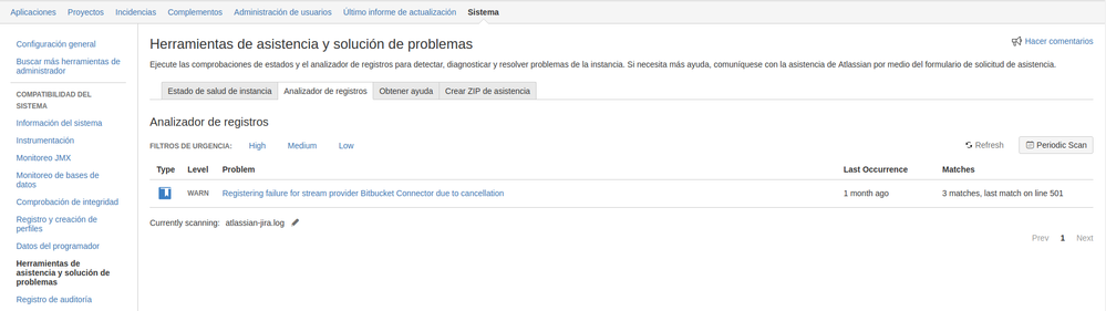

I found where was scheduled the daily report.
It looks like it was "spamming" a warning registered in my ~/atlassian-jira.log that occurred 1 month ago (probable when bitbucket went down and couldn't connect with it)
