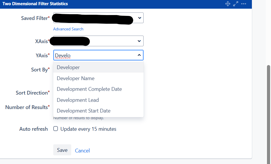

In my current environment,  we have the Due Date field , it was not displaying in the two-dimensional filter in Jira. on any x-axis or y-axis.
Marc -Devoteam-
October 30, 2025
Hi @keerthika Narra
This seems not to be possible regarding still open feature request, JRASERVER-40193.
Currently you could look at a 3rd party integration to make this possible, like custom charts

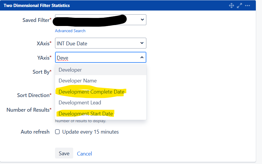

keerthika Narra
October 30, 2025
@Marc -Devoteam- Yes i can see the above post from Atlassian portal.
But here i have one question i can see other date date fields. From below screen shot when i search with other date fields it was populating the values.
