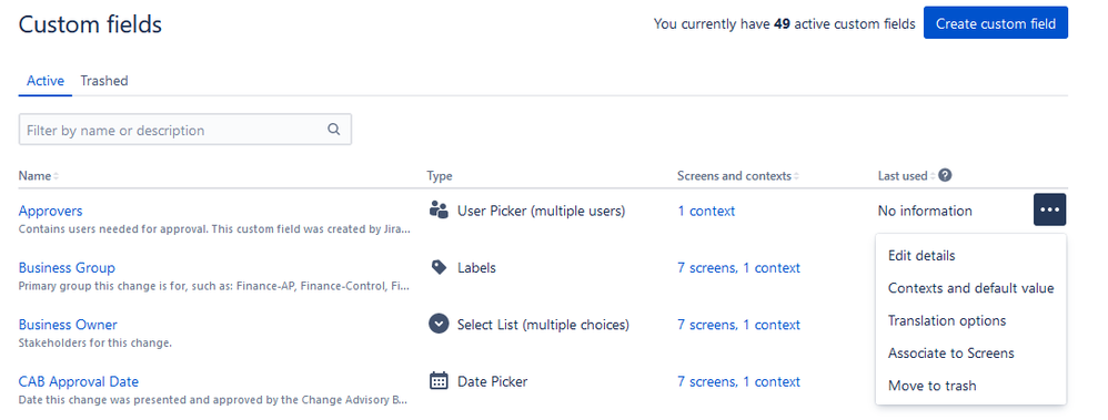

Thanks for the help Tim!! Would you be able to help me with where to find the customfield ID?
Tim Perrault
January 10, 2022
If you go to settings --> Issues --> Custom Fields. You can search for the custom field. Once you find the custom field you should see 3 dots, click on this then hover over edit and you will see a URL on the bottom of your browser and at the end of the URL you should see the ID. Something like below:

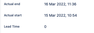

I have the same requirement and tried this approach but the value ends up being zero instead of one day. What do I miss?Screenshot 2022-03-16 at 11.44.38 AM.png

Could you please share here the expression you are using for the calculation, @Teh Kok How ?
Teh Kok How
March 16, 2022
This works for me: `{{issue.Actual start.diff(now).days}}`

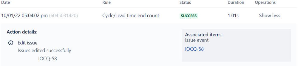

Can you share a screenshot of the audit log when you run it?
Fenner Matheus
January 10, 2022

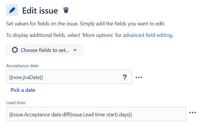

In this automation I also populate a different field with the current date, and this action is working fine...just the date diff that isn't =(
