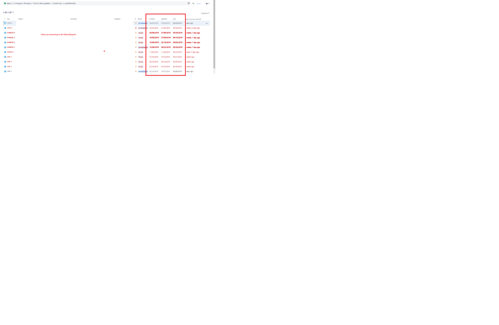

We tried changing the date format for our JIRA CLOUD version, but due to some issues we had to undo the changes. Due to all this, the dates showing on our Reports and Filters are not messed up.  Although the dates at the task/subtask levels are showing correctly. Its just that now our reports are NOT at all useful.
Is there a way to fix this?
Please advise.
Thanks'

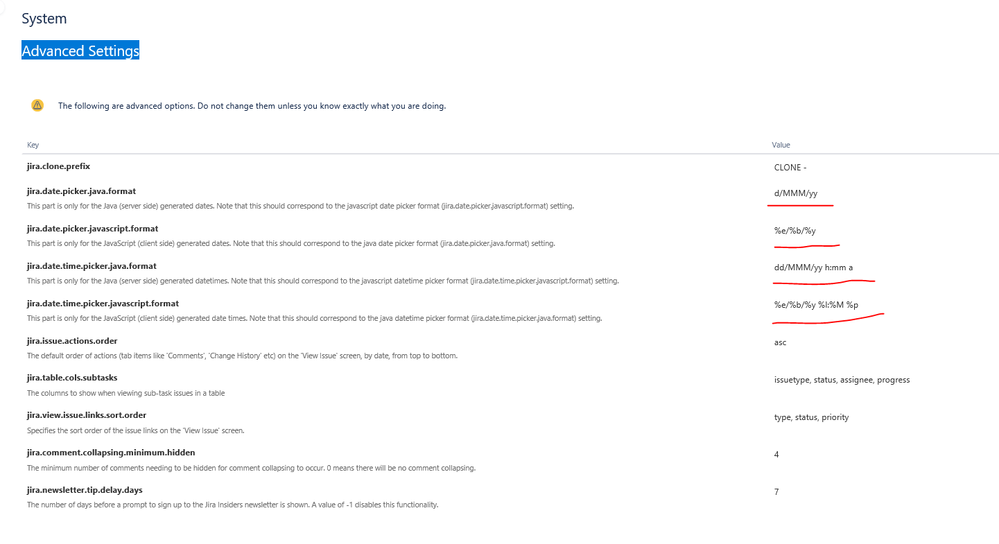

Additionally, if I have to change the default (YYYY/MM/DD) date format to MM/DD/YYYY then I guess I will have to change the settings at Advance level as well as Look and feel level correct?
Also, are there any know issues with regards to date formatting at project and at report level that you can share ? So that we are not messing anything unknowingly.

The Advanced settings under general configuration is where you can set the format which the user should use when adding a date to a date picker field, while the Look and feel is where you can set how the date will be displayed once the user submits the date. It is not required to have both with the same value, however, it is a good practice to avoid confusion and questions like "Why I am adding 2019/08/01 and it is appearing like 01/08/2018?".
Additionally, there shouldn't be any problems in changing the format from the default (YYYY/MM/DD) to MM/DD/YYYY. This is a very common changing and should work just fine for your instance.
About any other issues regarding this matter, I'm not aware of anything about this, but I would avoid using special characters to define the separators (Like 01*08*2019) since it is rendered in JAVA language and might not work. Anyway, it can be easily undone by switching back to the default values in case any problem happens. :)
