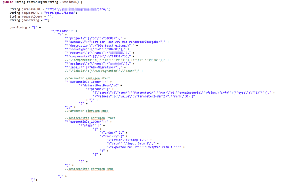

From a Test, I'm able to retrieve the dataset information,
but unfortunatly I don't know how to create a Test issue with a dataset.
When I'm doing my POST: https://jiraServer/rest/api/2/issue
with the dataset custom field info
 "customfield_16803": {
            "datasetRestBean": { "params": [ {
                        "param": { "id"1, "name""Url",       "rank"0,     "combinatorial"false,
                            "info": {
                                "type""TEXT"
                        "values": [
                                "value""http://prod",
                                "rank"1
 I get the error:
    "errorMessages": [],
    "errors": {
        "customfield_16803""Field 'customfield_16803' cannot be set. It is not on the appropriate screen, or unknown."
How can I create a Test with a dataset?
Thanks for help.

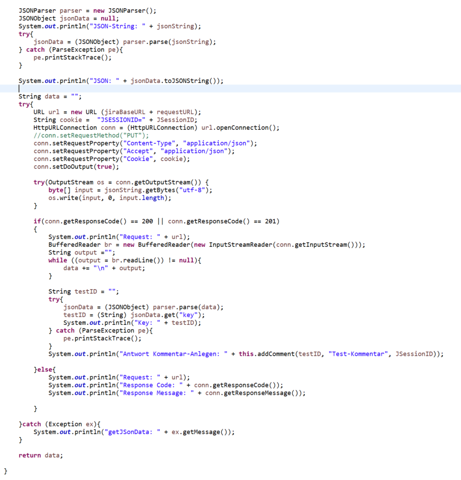

This is my call in java.
The normal creation of an test via rest api works fine but if I insert die customfield for the params than I get the 400.
I have tried some variants of the customfield structure, e.g. with an without the the datasetRestBean tag but nothing works. it returns always the 400.
I haven't also find a spezial operation like it exists for adding comments to an issue like "...rest/api/2/issue/<<issueKey>>/comment" to add params to an test issue.
Hopefully someone can help me with this problem. Thanks

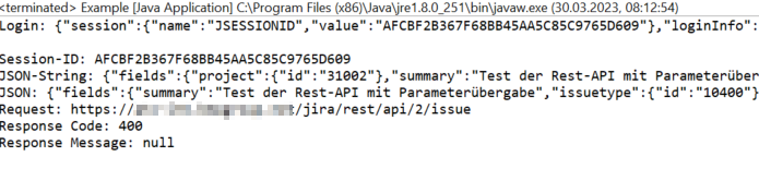

March 29, 2023
and this is the answer I get:
