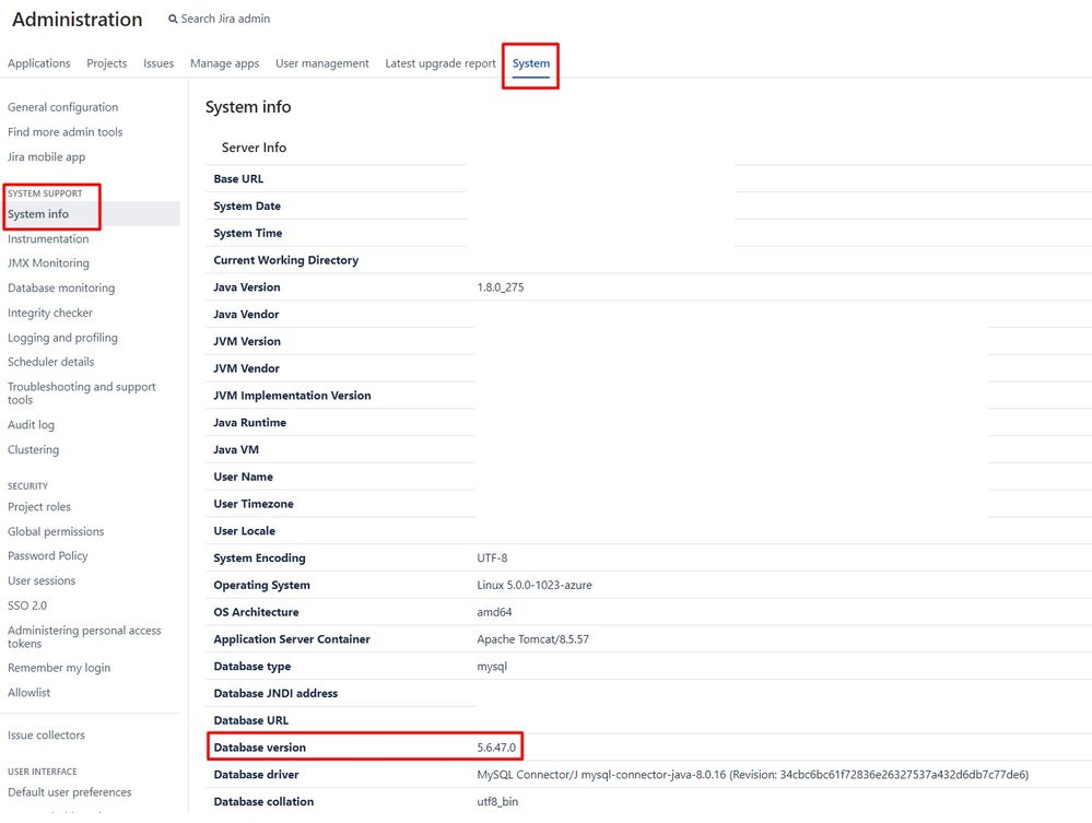

When I go to database version, it is not the correct version. I am using MySQL 8.0.16 but the version showed is 5.6.47.0. Moreover, I have the 8.14.1 Jira version. I tried to connect jira with database using the script from the installing path unsuccessfully. Any idea what might be happening?

Hi Nic,
I mean if I go from Jira Administration --> System --> System support --> System info. See below:

Ok, the version that field shows is a simple extract - Jira is not trying to be clever, it's just reporting what the database driver and database service report when it asks "hey, what version are you?"
You've blanked out the JNDI and Database URL (thank you for thinking securely by default!), so I don't know which one you are using.  Most of us use the database url as it's easier to set up, and if you are using that, I would want to start by using the url to log a mysql command line client into that database - it should tell you what the version of the server is as you log in.  If you use something a bit more gui-y, then "SELECT VERSION()" should tell you.
The question is what those return?
It is also worth checking that it says MySQL and not Percona or MariaDB - I don't think the more recent versions of Jira do this, but there's a couple of older versions that would return odd numbers if connected to Maria (you shouldn't do that, it's not supported)

I ran the command "SELECT VERSION()" on GUI and the version is 8.0.15. From command line, I tested the connection between SQL and Jira and it worked successfully.
telnet df-hub-db-mysql02.mysql.database.azure.com 3306
Trying 13.69.105.208...
Connected to cr5.westeurope1-a.control.database.windows.net.
Escape character is '^]'.
L
5.6.47.0\▒▒▒▒▒▒▒▒▒▒!?▒▒▒▒▒▒▒▒▒▒▒▒mysql_native_passwordConnection closed by foreign host.
As you can see the version is not the correct.

Ah, the telnet is the giveaway - it is definitely connecting to a 5.6 installation of MySQL, not your 8 installation.  You've got two databases in play here, on different versions!
