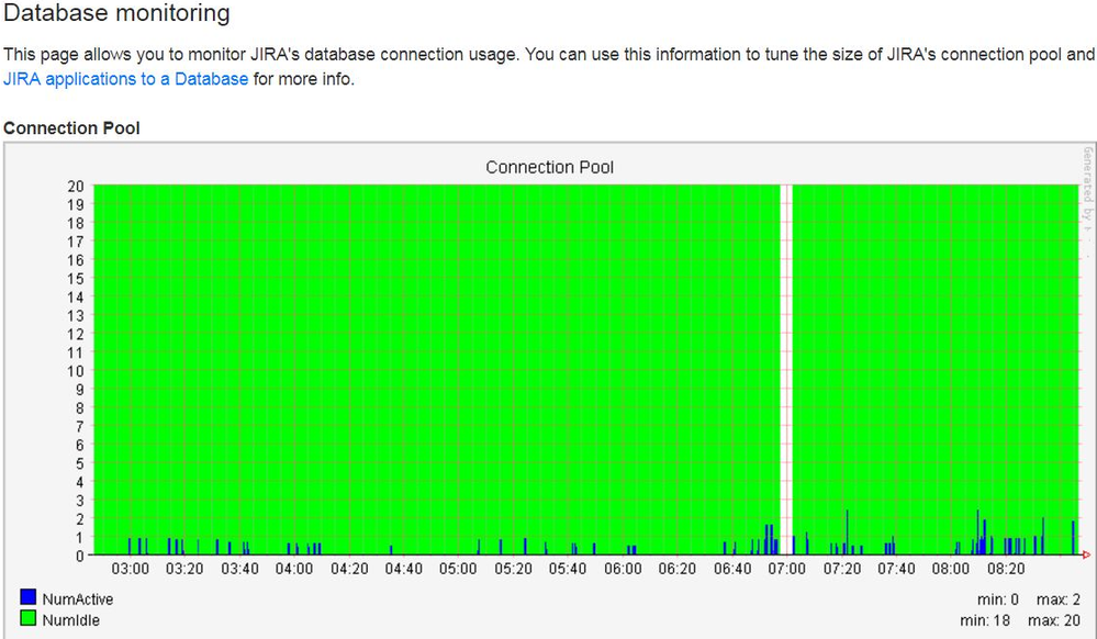

Peter P
July 26, 2017
What does it mean when there is a white space between the graph reporting? Occasionally Jira becomes unresponsive, would that whitespace be because jira isnt running so it isnt reporting? Is there something in a log file that I should be keyword searching for?
Any input is greatly appreciated.
Gaston Valente
July 27, 2017
Hi,
I only see this white spots spaces the application is down

Gaston Valente
February 6, 2018
Saba,
If you don't see any green or blue it means that there are no idle or active connections.
It is a weird condition but this can happen, maybe you can submit a formal ticket to atlassian support to get an answer.
Do you have any clue about what causes your performance issues? Maybe we can help you with that
Peter P
February 6, 2018
For us, when the java garbage collection ran it killed the app which introduced that blank in the graph. We resolved it by modifying the jira service with the following options to reduce the pause of locking Jira.
-XX:+UseG1GC -XX:MaxGCPauseMillis=300
I agree support will be better to assist you but id check your gc logs to see if there are long pauses which would make Jira unusable during the lock.

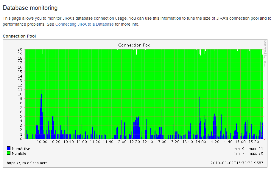

Surbhi_Kaushik
January 2, 2019
Hi,
Facing similar issue with lot of below warnings, is it like this due to pool exhaustion or just the all the connections are active.
Any help would be highly appreciated as this in our JIRA production and impacting all the users.
2018-12-26 10:02:15,504 http-nio-8080-exec-191 WARN skaushik1 602x11003971x7 y89vns 57.5.115.247,10.231.8.27 /secure/admin/ViewSystemInfo.jspa [c.a.jira.ofbiz.ConnectionPoolHealthSqlInterceptor] Dangerous use of multiple connections: taken => count=2; marks=[1-0]; pool=20/20
2018-12-26 10:02:15,505 http-nio-8080-exec-191 WARN skaushik1 602x11003971x7 y89vns 57.5.115.247,10.231.8.27 /secure/admin/ViewSystemInfo.jspa [c.a.jira.ofbiz.ConnectionPoolHealthSqlInterceptor] Dangerous use of multiple connections: replaced => count=1; marks=[0-0]; pool=19/20
