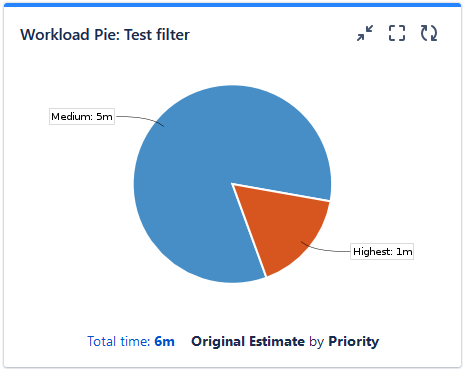

So I did some experiments. I create a Story and a Sub-task and put them in the current Sprint. I create the following simple JQL query:
project = "BPT" AND Sprint in openSprints()
I save that query as a filter.
I then alter the Priority and the Original Estimate of both both issue types in the following way:
  • Story = Medium Priority and Original Estimate = 5m
  • Sub-Task = Highest Priority and Original Estimate = 1m
I return to the issue filter page and apply the custom filter. It returns both the Story and the Sub-task with the correct data for the needed fields:
I then create a Workload Pie Chart that uses that saved filter and displays the Priority vs Original Estimate, and see this:
So, the chart is correctly displaying the results that includes both issue types. Everything is working correctly!

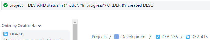

Looking at the filter, when I filter without the openSprints() part I see subtasks:

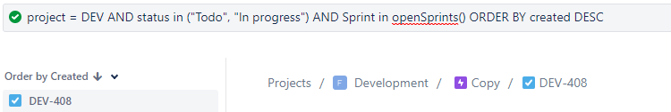

Then, when I add AND Sprint in openSprints(), They are gone...
(Specifically the task in the image is part of an epic, but other tasks that are not part of an epic are shown as well, while subtasks are removed)
I also tried filtering only on a specific Sprint and project with the filter project = DEV AND Sprint = 13 without any other parts in the JQL, and it seems to behave the same as shown above - subtasks are removed from the filter results, but are shown when filtering only using project = DEV.
