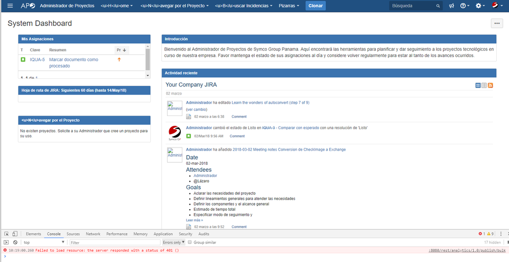

Hello, I am getting the following in my system dashboard (start screen):
Failed to load resource: the server responded with a status of 401 ()
and seems to be coming from:
http://x.x.x.x:8080/rest/analytics/1.0/publish/bulk
The screen menus do not seem to finish rendering since they have tags visible such as "<u>H</u>ome".

I do not believe that an error on that rest endpoint could cause the problem you are reporting here.  My thought is that this error too might be correlated to the source problem. But I am also not 100% clear on the problem you are seeing here.
  1. Could you post a screenshot of the error you are seeing?
  2. What version of Jira is this?
  3. When did this problem start?
Sylhos
March 15, 2018
Capture.PNGHere is a screenshot.   I get inconsistencies for the same user avatar and the menu rendering.  I temporarily disabled the cache to make sure I was getting the latest from the server, but the problem occurs with and without it.   Thanks for the help.

That does look very strange.

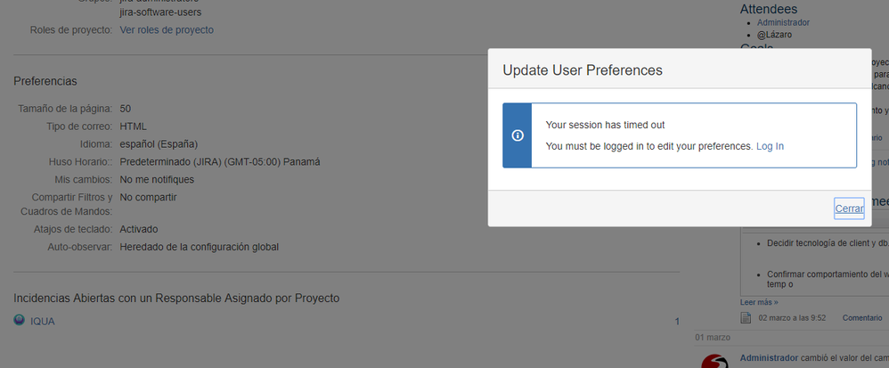

In terms of language, the system's default language is English, but my Admin user preference is set to Spanish.  When I went to the profile section to change it I get a "Your session timed out" error every time I click on the edit button near the preferences.
