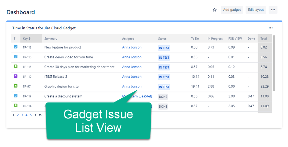

Hello @Ben Glasthal
As an alternative, you can try Time in Status for Jira Cloud developed by my SaaSJet team. All add-on reports are available in this gadget and you can control time in status data in the Issue List or Chart View
Our add-on is free up to 10 users.
Share reports with your colleagues or third-party analytical systems or export them to CSV or XLSX files.
Add-on has a 30-day free trial version.
Please, let me know if you have any questions
Hope it helps,
Valeriia
