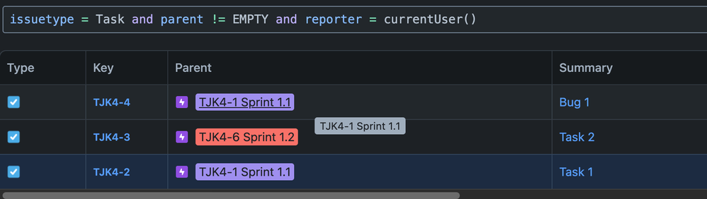

Jakub Koc
August 8, 2024
I'm afraid I won't be able to help you then. With Jira out of the box
from subtask point of view you can search for a parent but unfortunately it doesn't work the other way around and subtask field is not searchable from parent.
Only way to achieve what are you looking for is probably using some 3rd party app like ScriptRunner or one of examples shown below:
JQL for Jira Extension
JQL Booster Pack
Eventually you can create a separate filter for yourself where you can actually see the parent of the issue

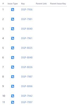

David Eade
August 8, 2024
There is no column with the value 'parent' - there is 'Parent Link' or 'Parent Issue Key' - neither of which returns any values - see attached...
