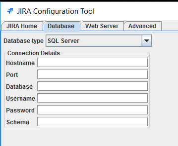

Trying to use an AD account to connect Jira to the SQL server but when i test the connection It says cant connect to the DB. On the SQl side i get the following error message "Attempting to use an NT account name with SQL Server Authentication." I tried to use the procedure below but it did not help. Any idea on how i can use an AD account to connect Jira to our SQL DB.
