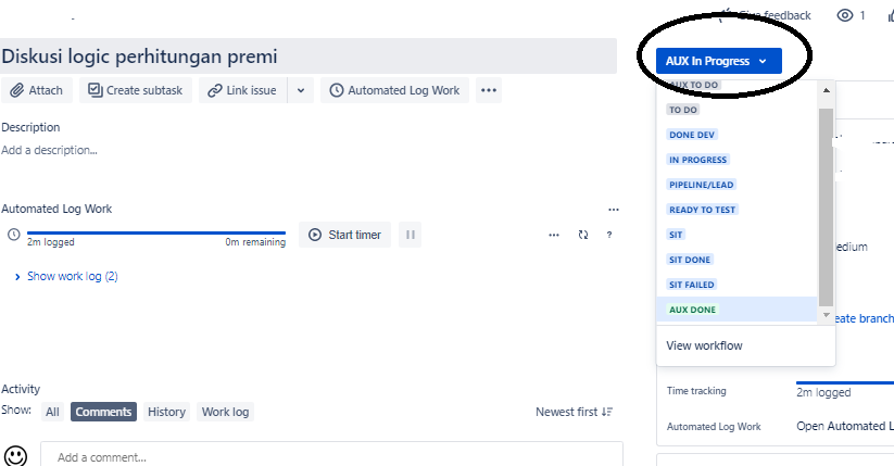

I have some issue, in my company managed software i am using 5 board :
1. Aux Board, With Status : Aux To Do>Aux In Progress>Aux Done
2. Development Board, with Status : To Do > In Progress> Done Dev> Ready To Test
3. QA Board, with status : Ready To SIT> SIT> SIT Failed> SIT Done
4. UAT Board, with status : Ready To UAT>UAT>UAT Failed>Done
5. Prod Issue Board, with status : Prod Issue>Prod Issue Fixing>Prod Issue Testing>Prod Issue Failed>Done
everytime i create new issue for eg in Aux Board, all the status on 5 board show on that issue, what i need to ask, it is possible in jira. when I creating new issue on each board the status only viewing relating status on that  board.

Hi Nic,
Thank you for this reply, actually what i need is, when i am in a one board just appear status related to that board.
Like this pic below, on this issue detail appear all issue status due to this issue creating on ax board, in need status appear is just aux in progress, aux to do and aux done.
It is possible?
Nic Brough -Adaptavist-
August 24, 2021
Ok, that's nothing to do with the board, the status are part of the workflow.
You need to edit the workflow, removing (or hiding with conditions) the transitions to the status you don't want that go out from the current status.
