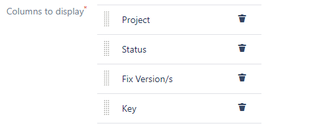

It seems that this could be achieved by adding a a filter results gadget to a dashboard and the selecting the necessary fields.
https://confluence.atlassian.com/jira064/adding-the-filter-results-gadget-720416922.html
As for the fields to includes
It looks like these four fields will satisfy most of your information, however it seems as though the platform involved in the project release, client commitment (tickets that are client committed and must be released), and notes would have to be custom fields added as well.

Thank you Zachary! Do you know how I can add these custom fields that are not on the default "columns to display" list?

I just re-read your comment and realized that I may have given you the wrong answer.
If you were asking "For custom fields already added how do I add them to the list".
There is a drop down box above the columns to be displayed where you can select additional custom fields. If those fields already exist in JIRA then they will display there
