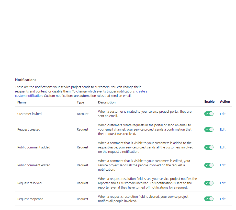

This is what I have in customer notifications

Everything looks normal there. One thing I might try is to disable/reenable the request created and then using a test customer account create an issue and see if a notification comes through. Otherwise is John mentioned you might want to open a support ticket.
