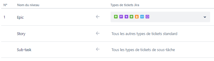

So in the ticket hierarchy, this would give:
If I want to make an Epic's initial parent request, I manage it with a custom issue link.
Like John Funk likes this
John Funk
February 29, 2024
Yes, that's what I would do. But what are all of those issue types associated with the Epic? It should probably just be the Epic issue type.
Julien REBILLARD
February 29, 2024
This allows me to have the new concept of parent - child in my stories. Like a Initiative, but with issue type Developpement, Evolution (issue type link with my JSM issue type).
So on my highest level issues (all types except story and subtasks) I have the "Add child" button displayed, and if I need to create a specific hierarchy between an epic and another type of level 1, I achieve it with a personalized issue link.

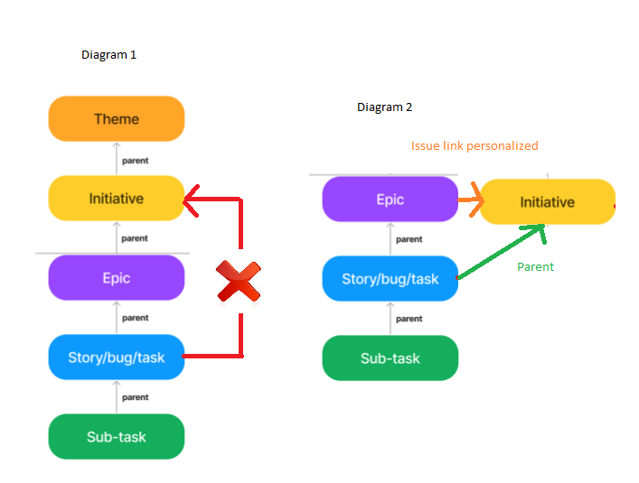

Julien REBILLARD
February 29, 2024
If I have an Agile division which does not necessarily require the creation of an Epic, in diagram 1 I am obliged to create an Epic to be able to attach a story to my initiative. Diagram 2 allows me to bypass the Epic while keeping the notion of Parent field, Diagram 2 correponds to all my issues types in the Epic level.
