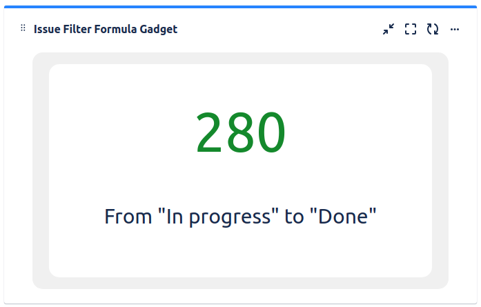

Another option would be to just display the Count of the issues. You can easily do this by using the Issue Filter Formula gadget or the Advanced Issue Filter Formula gadget offered by the same app.
For this,  create a Jira filter like the one mentioned by Esther and configure one of these gadgets to calculate COUNT for that filter.
