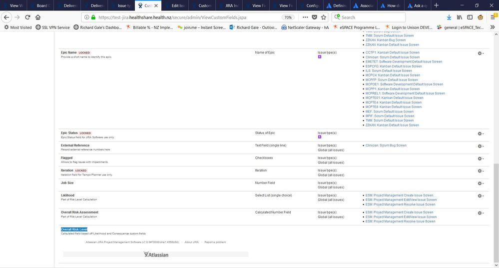

Was doing some work following https://plugins.atlassian.com/plugin/details/27136?_ga=2.68533269.561423346.1531273495-2122636972.1498681592
And inserted some code into the description box.
The issue is the custom list now seems to be broken as per screenshot
See 'Overall risk assessment' doesnt have config options and nothing below it?
What I have tried:
Clicking 'back' and removing code
Restoring from backup
However the backup doesnt seem to have removed the custom field list?
David Fischer
July 12, 2018
What happened is, you didn’t properly close the html comment in which the formula appears, which in turn broke the Custom Fields page.
If you look inside your JIRA log file (atlassian-jira.log), you’ll see ERRORs about that field followed by a URL. Navigate to that url to go to the Edit screen for the custom field, where you’ll be able to fix the formula and the html comment. Just close with -->

When I hit the URL https://test-jira.healthshare.health.nz/rest/activity-stream/1.0/preferences?_=1531452981622 it doesnt give me the page to update the edit screen  for the custom field?
Am I missing something?
I know the field ID from memory I believe it is 11002, can I use this to form up a field URL?
Yes I can, I used https://test-jira.healthshare.health.nz/secure/admin/ConfigureCustomField!default.jspa?customFieldId=11002

Just replace "ConfigureCustomField" with "EditCustomField" in the URL you tried:
https://test-jira.healthshare.health.nz/secure/admin/EditCustomField!default.jspa?customFieldId=11002
As for the errors you found in the logs, they are irrelevant to the custom field. You need to look for "com.innovalog.jmcf.fields" - and you'll need to display an issue that is supposed to show the custom field (or re-index Jira) to make the error appear in the logs.
