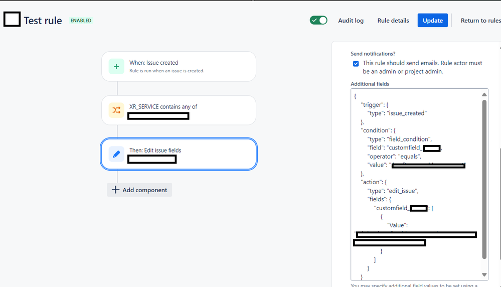

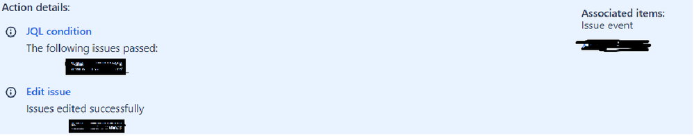

here is the rule that I am running. It is not working, and Rule automation audit logs show success.
Scenario - User is populating the custom field to populated custom field 1 and based on it, i would like to populate custom field 2.
The rule runs perfectly fine however the custom field 2 does not get populated.
Any help in this regard is greatly appreciated.
    "trigger": {
        "type": "issue_created"
    "condition": {
        "type": "field_condition",
        "field": "customfield_1",
        "operator": "equals",
        "value": "Service 1"
    "action": {
        "type": "edit_issue",
        "fields": {
            "customfield_2": [
                    "Value": "Team 1"
Here is the output -

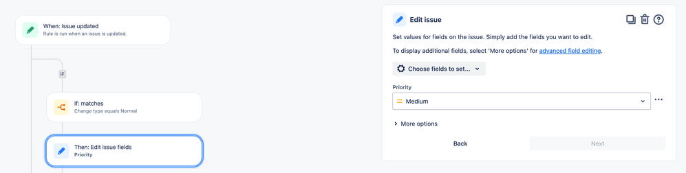

Before anything else, @Umesh Kulkarni: why are you trying to use json in the additional fields instead of using the simple editor:

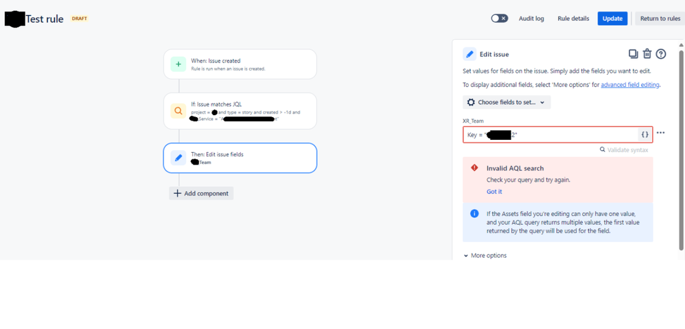

I gave a try to use additional fields because the usual way did not work. I am using custom fields as mentioned in my earlier post and i kept getting validation errors like shown in the screenshot below. This query does work well when searched from within "Assets" but JIRA rule automation gives error.
for this input it gave error - (data was not an array (Team))
