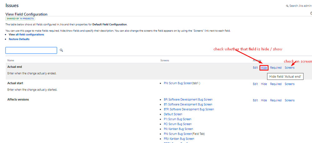

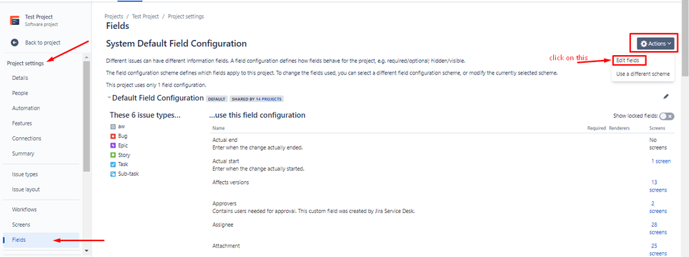

Hi @Becky Klein  you can check the following steps as shown in image below : field config.png
This might help .
Thanks,
Rishav
