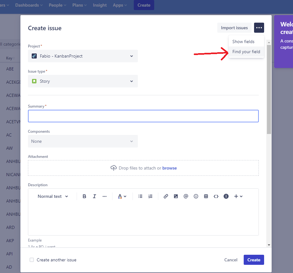

Hi @Gregory Kremer ,
if it is global, it is not hidden from field configuration so you can try to use "find your field" that should help us to retrieve the reason
