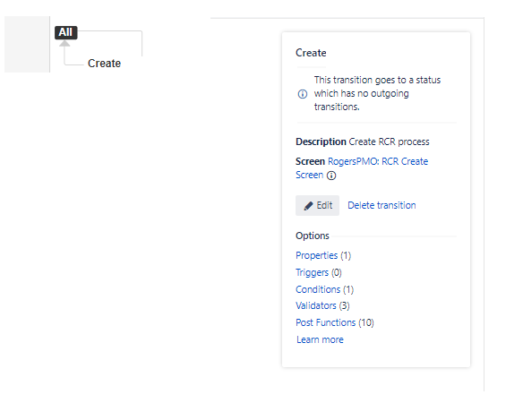

Yes you can. We use a transition that calls itself and then copy some of the field to the newly created ticket with a JMWE plugin. However, this is a costly one since you have to purchase the plugin.
Instructions:
  1. Create a new Status that calls itself in your workflowjira_button_trigger.png
  2. You can create a new dialog screen with the fields you want and assign it to the transition (e.g Create RCR Process Screen)
  3. Add a post function to create the new ticket.  function: https://innovalog.atlassian.net/wiki/spaces/JMWE/pages/139202100/Create%2BClone%2Bissue%2Bs
  4. You can copy the tickets from the parent ticket calling the post-function
  5. You can link to the parent ticket as well through the various options.

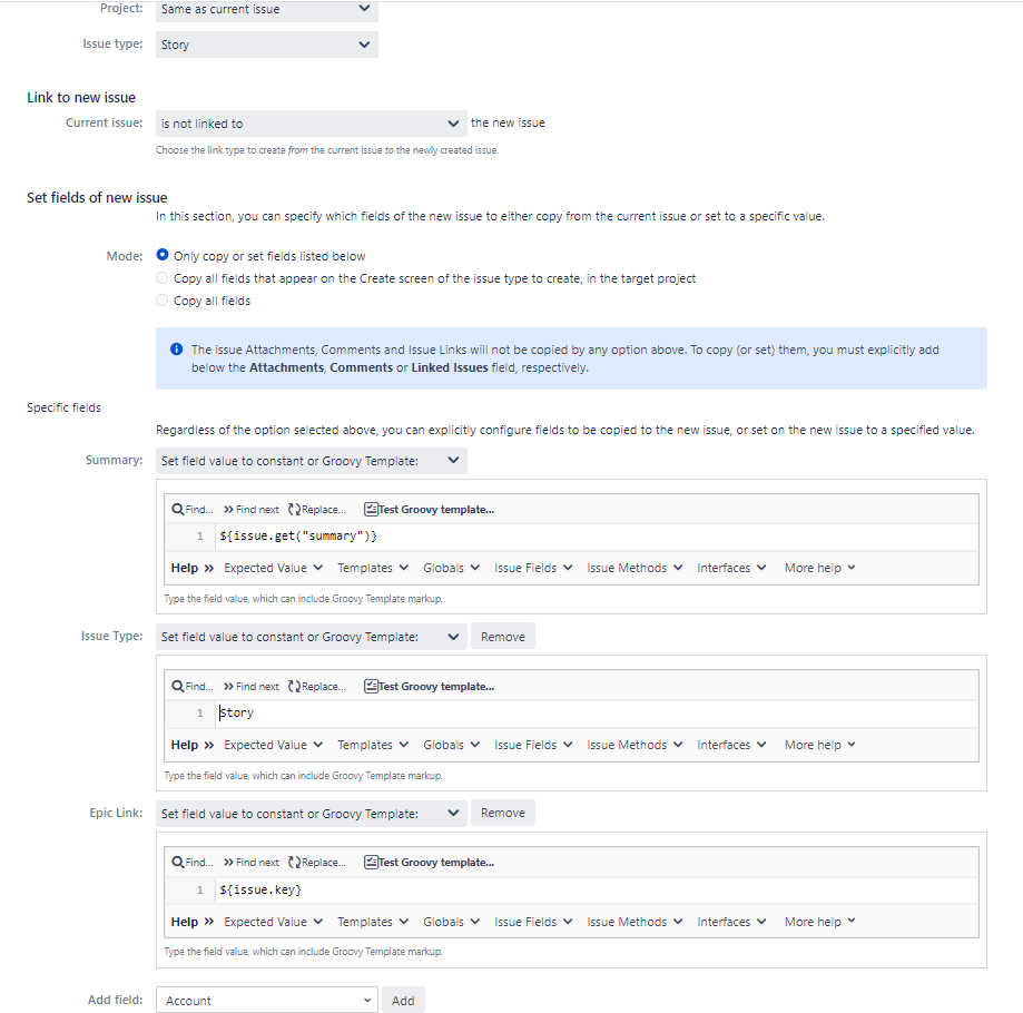

Thanks for your answer.
I was able to create this type of button but I'm getting some unwanted actions caused by this method...
When I send form it creates linked Story and also it updates current Issue. I need to keep current Issue  as it was.
My Create / Clone Issue(s) Post-function looks like that
Maybe you see what is causing Epic to update?
Fabian Lim
July 7, 2021
Hi @Mantas Geležinis
The epic will be updated because there are new stories linked to it, but nothing else should changed. What other fields or actions are being updated?
A few other things to check:
- No need to have the second field about issue types, it's already covered with your issue type field under the project field "same as current project"
