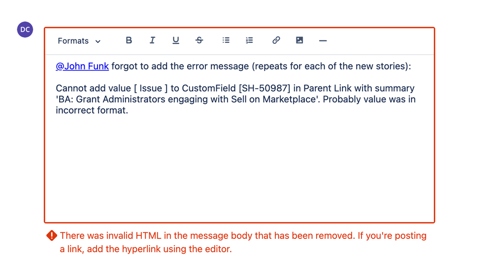

David Cook
April 18, 2025
John Funk
April 19, 2025
Hi @David Cook  - Welcome to the Atlassian Community!
You should be using the Parent field and not the Parent Link field, assuming you are using Cloud. Also, it seems to be complaining about the Summary for that issue - maybe because it has a colon (:) and that is not getting handled adequately on the import. Maybe change that for now to take the colon out.

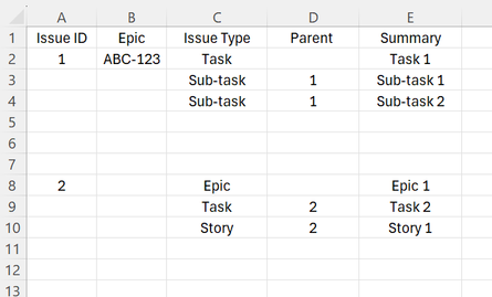

John Funk
April 19, 2025
Can you share a screenshot of your CSV file in a spreadsheet format?
Below is my model.
John Funk
April 19, 2025
