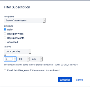

I believe the easiest way to achieve your need would be creating two subscriptions for the filter. These would be steps:
1 - Navigate to your filter > Details > Create subscription > Configure the following subscription:

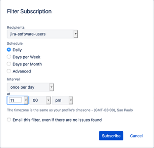

2 - Navigate back to the issue navigator > Details > Create subscription > Configure the following subscription:
Let me know if it works for you.
