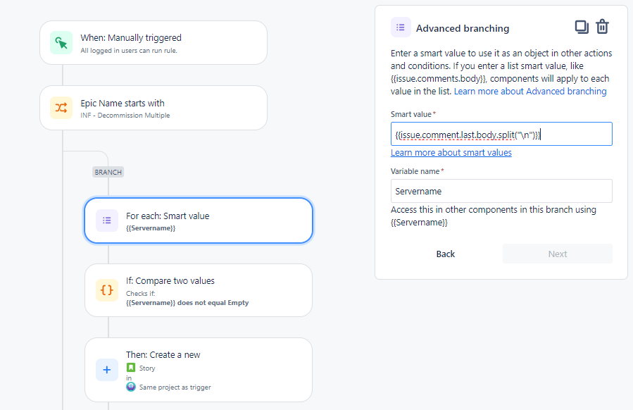

We are using Jira Software, not Jira Service management. I have a list of servers in the description of the main Epic with name "INF - Decommission Multiple Servers".
First, I will manually trigger the automation from the epic. But it will only run when the Epic name starts with "INF - Decommission Multiple".
 I need some help from the Advanced branching. Which smart value do I need to read the list of servers and how to create a subtask from this with that value in the name of this task.?

I guess something like this (updated)? if I trigger it from the last comment with the list off Servers:

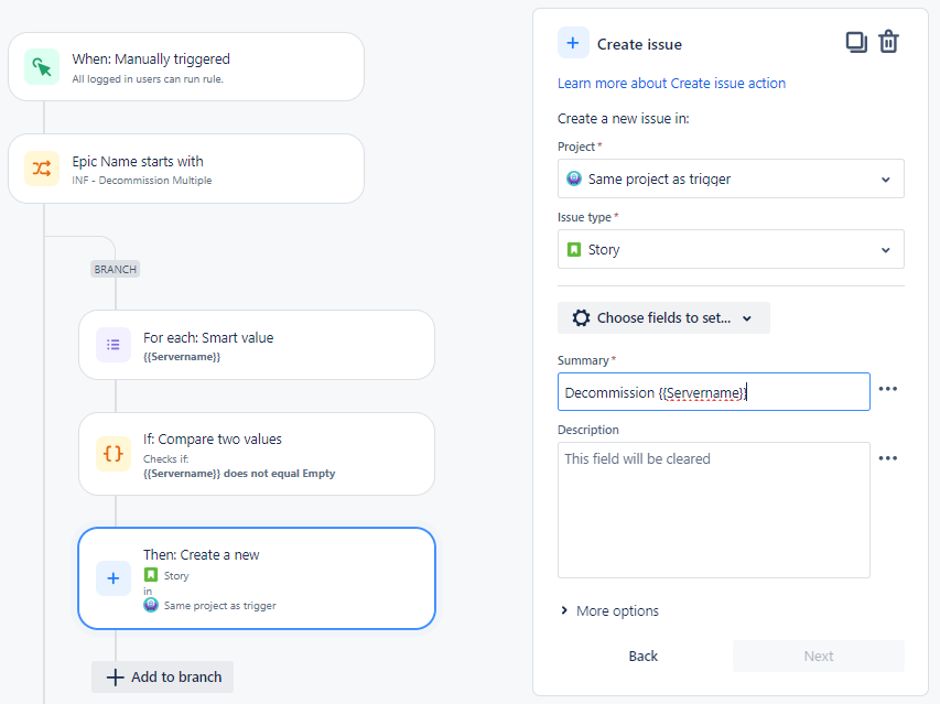

Is below correct is I want to create the Story in the main Epic? or do I need to specify the parent epic?

Rules and smart values work pretty much the same way in JSM and Jira Software. So the smart value in advanced branching remains the same (you can change the variable name to "serverName" though). This is assuming the servers are listed line by line. If it's a different format, like a comma-separated list, you would have to change the separator in the smart value.
In the last step, you would create an issue of type Epic in project INF, and the summary would be
Decommission {{serverName}}
 And you won't need anything in "Additional Fields" I guess.

Yes, this looks mostly correct. Just a couple of nits
1. The smart value should be issue.comments.last.body.split("\n"), not "issue.comment.last...".
2. In the second image, you can select "Epic Link" in the "Choose Fields to set..." selection, and then select your epic from the dropdown that comes up.

Hariharan Iyer
February 9, 2024
does the split("\n" also work for this Smart Value?
Yes, it would work for any multi-line string value.

Thanks @Hariharan Iyer  instead of epic link, I need to use Parent right? And if I select Current Issue it will select the Parent Epic, or is this an incorrect assumption?
