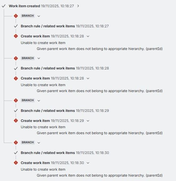

What I'm hoping to be able to achieve is, when I use the 'Associated JIRA Issues' option in GSD, I want to trigger the creation of multiple Issues/Tasks within a JIRA project. The JIRA project in question has 5 different Issue Type options ('Task' and 4 custom options). I've attempted to use an automation, so that when a Task is created in the project then 4 additional Issues/Tasks are created (1 for each of the custom Issue Type options) but get the message in the audit log saying "Given parent work item does not belong to the appropriate hierarchy".

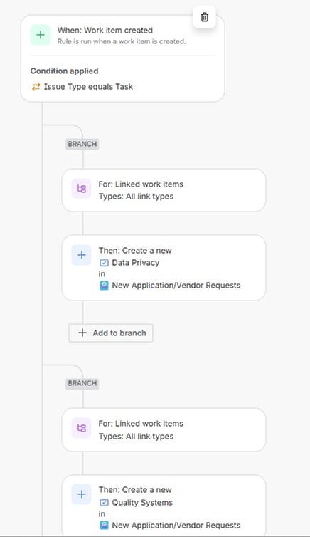

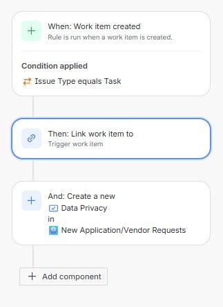

I've only previously used Linked Issues manually and don't really understand the JIRA help. I've now tried to create an automation to handle this, but I'm seeing the same message. Presumably because I've not configured it correctly (see screenshot);Linked Issues automation attempt.jpg);

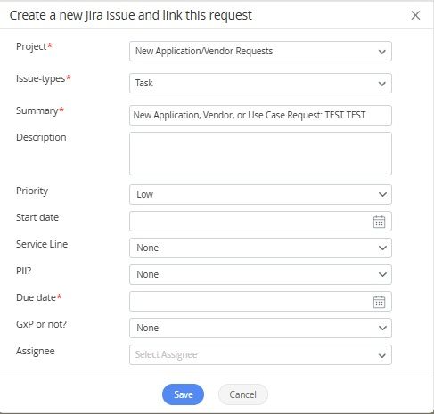

3. I have included a screenshot of the box that we complete from GSD, which triggers the creation of the JIRA Issue; GSD box to create JIRA Issue.jpg
4/5. The audit log is showing the message 'Given parent work item does not belong to the appropriate hierarchy', and this is where the issue is;

Marc -Devoteam-
November 27, 2025
Hi @Marcus Burnett
What are the details of the create action in a branch?
Where is the link action mentioned?
As you can't set a parent in this action, as you are linking.

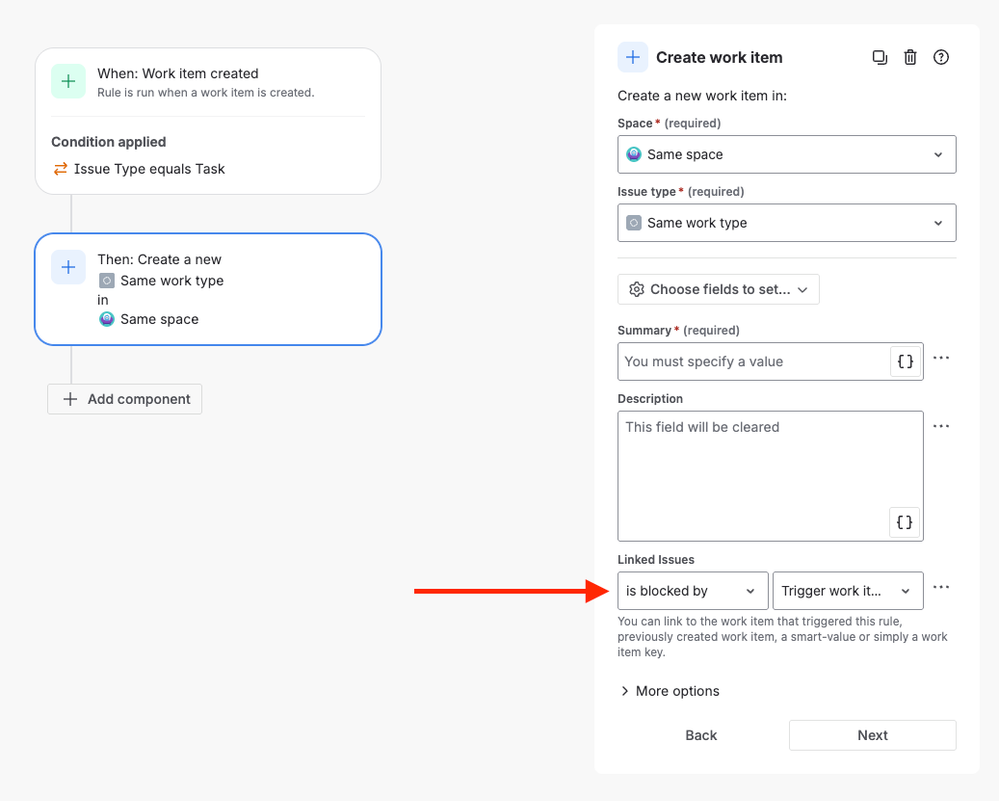

You do not need the Branch components. You can link a new item being created to the trigger item directly within the Create Work Item step.
Example

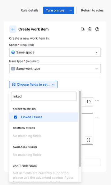

To link items you are creating to the one that triggered the automation, in the Create Work Item action use the Choose fields button to select the Linked Issues field.

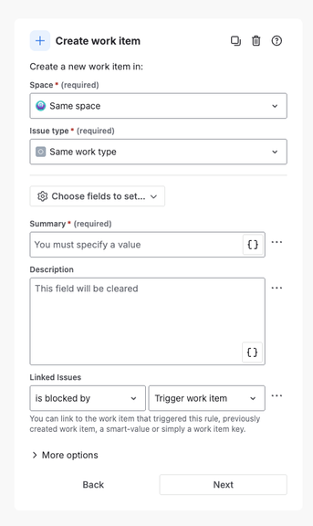

You will see the Linked Issues field appear (at the bottom of my next screen image). It shows the type of link relationship in the first pull down. You can change that as needed. The second pull down indicates which item the new item will be linked to. This defaults to Trigger work item which doesn't need to be changed in your case.

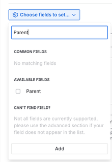

Make sure that you do not have the Parent field selected. If you do, de-select it.
