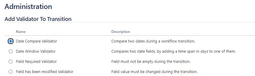

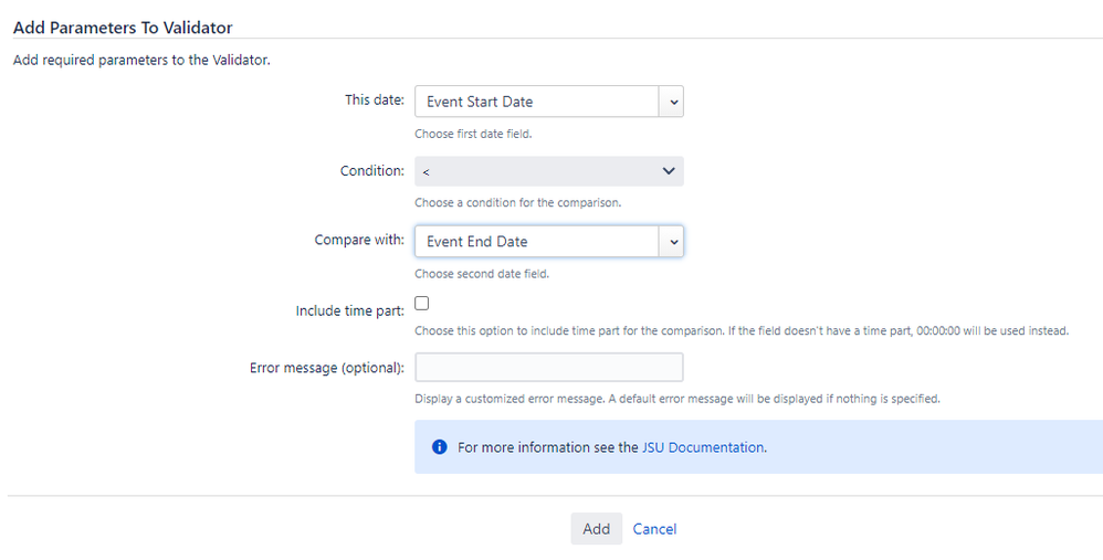

Yes this would be implemented as a validator on the create transition.
Note to access the create transition you need to view the workflow in diagram mode and select the line from the grey circle.
Depending on whether this is an on premise or cloud instance will then impact how you can compare the dates.
Cloud
On Premise
To do date comparisons on premise you need to use a plugin here is an example using JSU

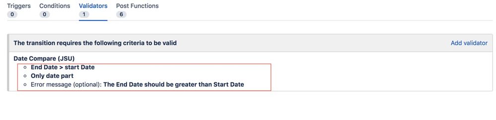

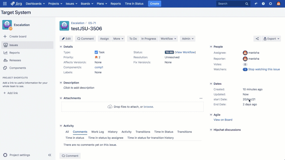

Please add the Date Compare (JSU) validator to the specific workflow transition.
Now, save and publish the workflow and rerun the scenario, if the End date is smaller than the Start date, you will see the error message. Please refer to the below gif file for details.
Please let us know if you face any issues.
