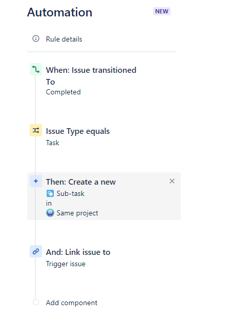

Is this parent issue a standard story level issue (with a sub-task being the child issue) or does the epic act as the parent and stories/tasks being child issues?
Either way, you could do this via Automation for Jira.
  • You could use the trigger when a parent issue is transitioned to done/completed.
  • Then you could add further conditions based on issue fields/JQL/etc (if any) — I don't have the full picture of what you're trying to do so I can comment on this further until I know more.
  • Then perform an action in your rule: Create sub-tasks (and add a summary of what that sub-task should be).

At its basic form, you could use something like this - and make modifications as needed.

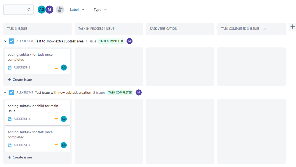

Hi, so both of these actions worked for what was needed, thank you so much! However, it created two different boards for the subtasks. Is there a way to fix that? I would like all subtask to show together if possible.

Yes, this is a pretty straightforward automation rule.
  • TRIGGER: Issue Transitioned (To your Resolved status)
  • ACTION: Create Issue

Yes - But, what is your definition of "child issue"?  Are you meaning linked?  If so, you can include the Linked Issues field in your Create Issue and set it to link to the trigger issue.
Mark Segall
October 27, 2022
Based upon your response, You would use the Create Issue action as mentioned above and set the issue Type to Sub-Task or even use the Create Sub-Task action.
