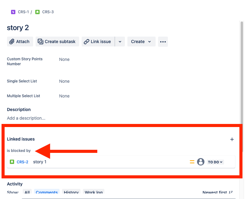

"Linked Issues": I am referring to the section that displays when you are viewing an individual issue, shown below within the red box. The arrow is pointing to the Inward Description or the Outward Description for the link type used to link issue CRS-3 with CRS-2.

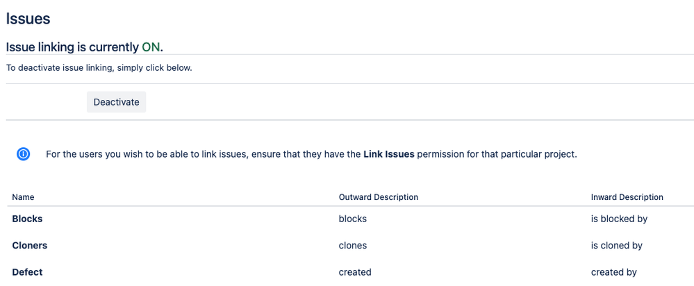

To determine if that is the Inward Description or the Outward Description you would need to look at the Issue Link Types that have been defined for your instance. A Jira Administrator can access that information at
https://<your Base URL>/secure/admin/ViewLinkTypes!default.jspa
Here is a partial screen image from my instance.
I said "The issue that shows the "Outward Description" in its Linked Issues section is the one that "triggers" the rule."
In the example above, viewing CRS-3 we see the description in the Linked Issue section is "is blocked by". When we look at the Issue Link Types screen we see that "is blocked by" is in the Inward Description column for the Blocks link type.

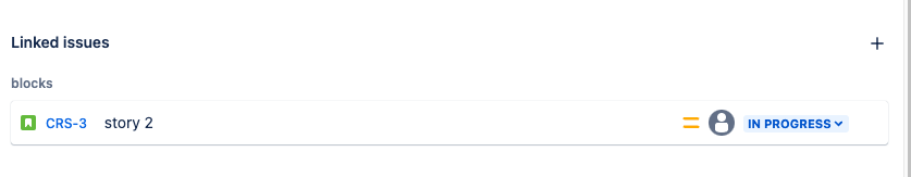

If we looked at the linked issue, CRS-2, in its Linked Issue section we would see that it displays "blocks", which is in the Outward Description column.
In this case a rule triggered by the creation of this blocks/is-blocked-by link would be triggered by CRS-2, even if the creation of the link was initiated from CRS-3.
The smart value {{linkType}} will give you only the Name of the link type that was used; i.e. Cloners or Defect, from the same screen image above. I don't see any way yet to use that smart value to obtain the Inward or Outward Descriptions associated with the link type.
