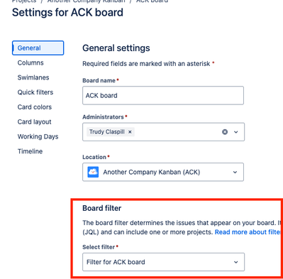

If you want to show different issues in the board, then you need to create your own filter that selects the issues you want to show. When you have that filter created and saved, go to the Configure Board option for that board and select the filter you have saved:
After making that change you should also check the Columns configuration and make sure that you have the columns you want for your board and all the statuses are mapped correctly to columns.
