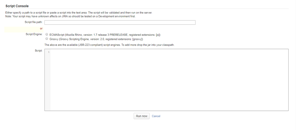

Wero August 2, 2017
Hi Thanos,
I don't have the file tab in the script console. I am using SR 2.1.15.
Thanos Batagiannis [Adaptavist]
August 2, 2017
Hi Weronika,
Judging from the photo and having a second look at your pom I can ee that you use the 2.1.15 version of the ScripRunner. To be honest I am not sure that with this version is possible to do what you want.
Is it possible to use a 3.* version of the plugin ?
