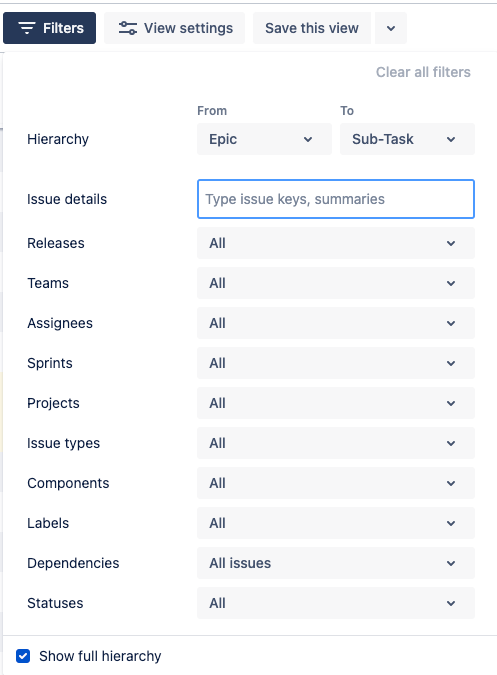

Harriet King
July 11, 2022
Hi @Omar Erminy
Thanks for coming back to me - strangely I don't see this option here at all.. I attached a screenshot to check I'm looking in the right place?
Thanks
Omar Erminy
July 11, 2022
You are right, although I am not sure if you are in the Roadmap view. It could also be the case that this is different from version to version. We have the on-premise version. Maybe the cloud version is different.
At least from that screenshot you shared, mine looks slightly different.
Sorry I can't be of more help @Harriet King.
