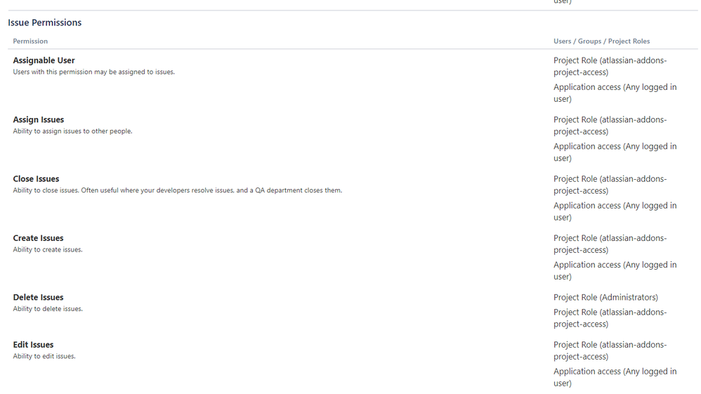

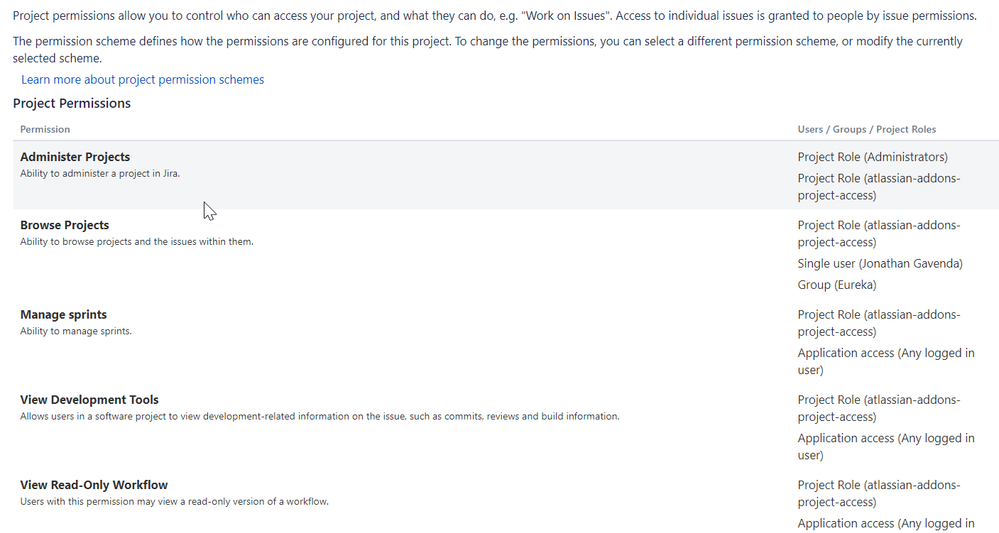

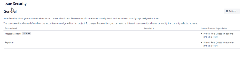

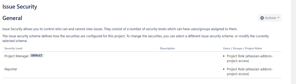

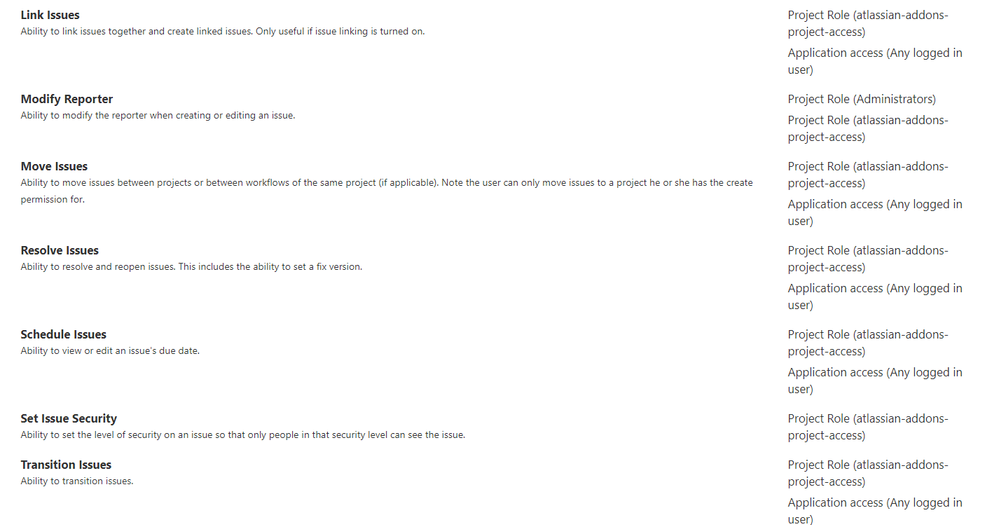

Jonathan Gavenda
November 23, 2018
2018-11-23 11_45_43-Netflix.png2018-11-23 11_45_02-Project Credit Eureka - Project Permissions - Jira.png2018-11-23 11_44_53-Project Credit Eureka - Project Permissions - Jira.png2018-11-23 11_44_41-Netflix.png

Nic Brough -Adaptavist-
November 28, 2018
Ok, I can't see anything that would be doing this, unless you're not logging in as the user or a member of the group that is named in the "browse" permission (it looks like you are explicitly naming yourself)
So the other thing is to look at the issue security - is there an issue security scheme in place on the project?
November 28, 2018
Ok, so as I said, the issue security scheme is hiding it.
