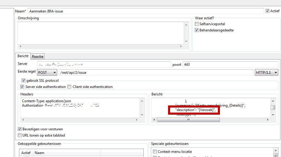

Hey @Steven Breton van Groll ,
Thank you for still responding to me. I really do appreciate it.
I have it configured exactly like that, but I've noticed that TOPdesk sends the following http request:
https://jiraserver?/rest/api/2/issue A question mark is inserted, which throws off the entire thing. Could be a bug in the ancient version we're running.

As you can see, field description is a variable (verzoek) of our ITSM-tool. In the process of sending the information to JIRA field description will be filled in automatically with text of our ITSM-tool. Often this variable is filled with information on several lines.
Does anyone have a solution for this?
@Steven Breton van Groll : Did you got any solution for the issue of multiline description?
@Jaydeep.Patel: well in our ITSM-tool (TOPdesk) it is possible to use this escape \J<variable>\j.
With this escape TOPdesk is able to send text in multiline to JIRA.
Since release November 2017 TOPdesk has new functionality to connect with third applications like JIRA. It names "action sequences". With this functionality it is possible to execute several http-requests in sequence. Every request will be escaped automatically by TOPdesk, so text will be sent mutiline as well.

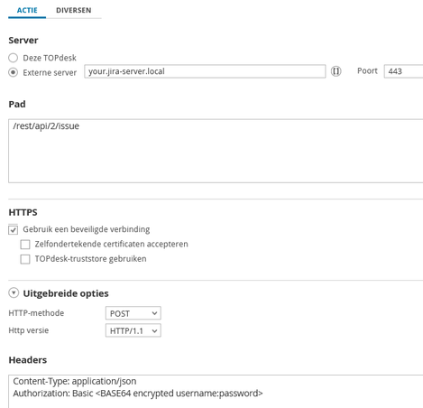

The company I work for is still using TOPdesk 5.4 SP1, which means we can't use the new API.
I've configured an HTTP request;
Server: jira.server.local Port 443
Initial Line: POST /rest/api/2/issue HTTP/1.1
Headers
Content-Type: application/json
Accept: application/json
Authorization: Basic <encoded credentials>
Message
"fields": {
"project":
"key": "MON"
"summary": "TEST [Incident_Number]",
"description": "Creating an issue via REST API and topdesk",
"issuetype": {
"name": "Bug"
"reporter": {
"name": "my name"
It seems TOPdesk prepends http:// ; is there something in the Jira setup I am missing?
