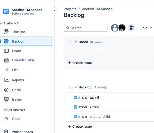

In a Team Managed Software project, if the Backlog feature is enabled then issues created using the Create button from the menu bar will automatically be added to the Backlog issue list on the Backlog screen. This is separate from the list of issues displayed on the Board. If you have the Backlog enabled and you want an issue immediately displayed on the board when you create it, you would need to use the +Create issue option shown at the bottom of the columns in the Board view or at the bottom of the Board list on the Backlog screen.

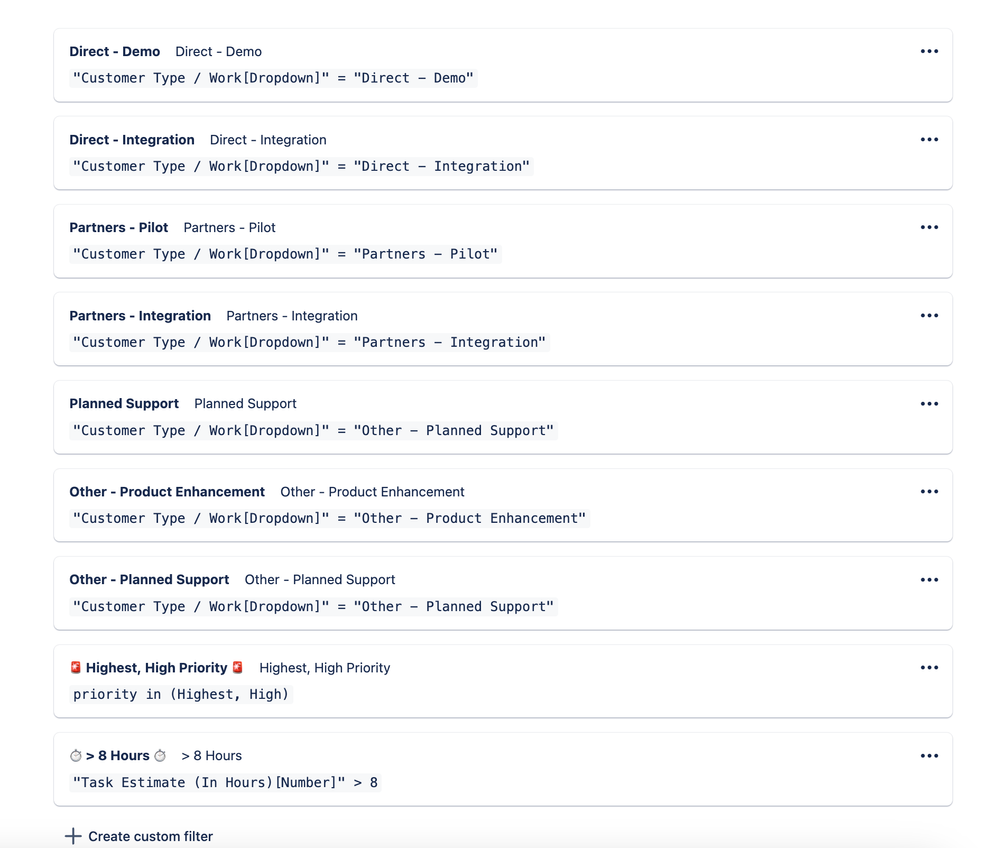

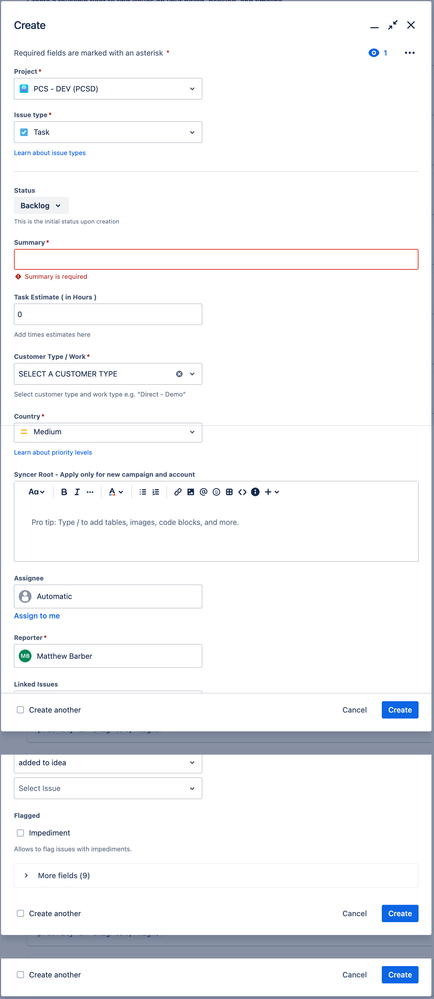

Would it be possible to share an image of the board's filter, and the ticket being created, also the column setup? It would help identify the setup better.
Matthew Barber
October 30, 2024
Hi, thanks for getting in touch. Some screenshots are attached. It’s just such a weird issue; perhaps re-indexing might trigger it to sort itself out. I’m using a team-managed software project.
Screenshot 2024-10-30 at 07.29.57.pngScreenshot 2024-10-30 at 07.26.23.pngticket.png
