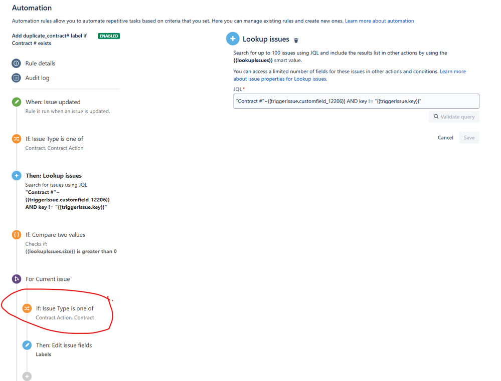

Made 1 automation to add and 1 to remove the label. Here's the one to add:
Kathy Dickason
May 18, 2026
@Trudy P Claspill @Monica Mesiha  Trudy, we are having an issue with the automation I posted in my response above.  This automation is working, but it is adding the Label to other issue types, instead of just the ones we want, which are now Contract and Contract Action (slight update from screen gab shown above).
I added to the automation (see red circle) to try to confine it to only adding the label to the two issue types we want, and this still is not confining it to only these issue types.   What do I have wrong?  Thank you in advance!
