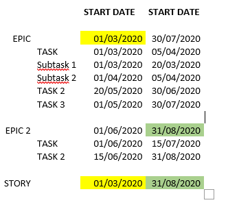

Is it possible to create an automation rule that assigns to the due date of a story the due date valor most future present among all the present issues of that project?
Then I would like to do the same thing with the start date, taking the most recent date present.
For example
Thank you

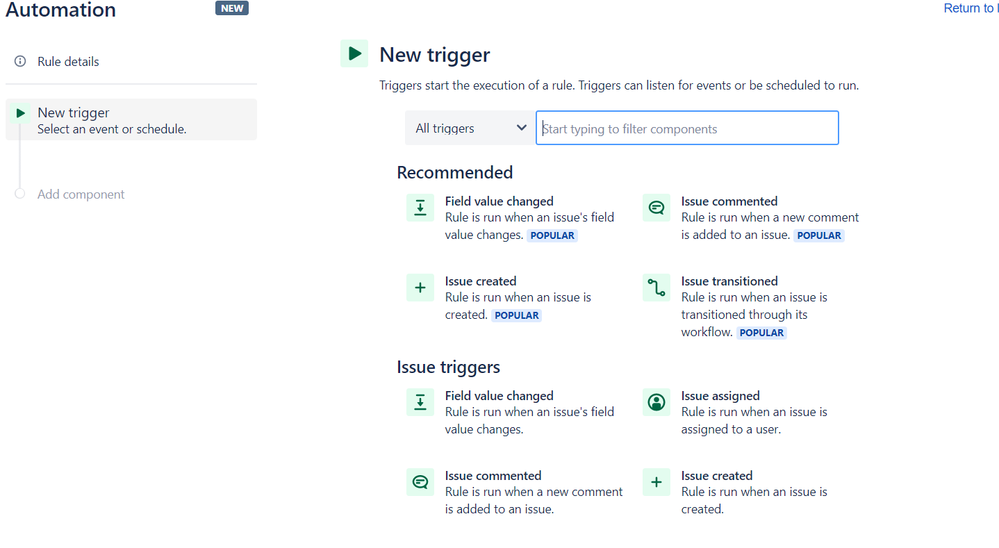

Silvia Fattori
October 30, 2020
Thank you for your quick response.
My search for two max dates should be done on all types of issues in the project (so not only subtask). I would need to know how to put it in the automations.

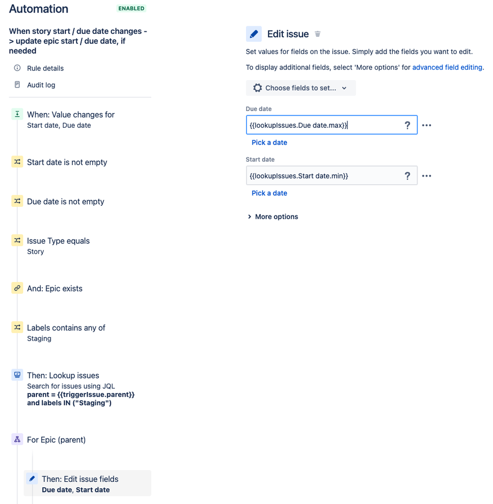

David Ashlock
March 2, 2022
Hi @Silvia Fattori , this can be done with the {{lookupissues.Due date.max}} and {{lookupissues.Start date.min}} smart value functions.  See attached.

@Bill Sheboy i was actually looking for a way to specifically ask you if you can do the following:
{{lookupissues.Due date.max.diff(issue.Start date).businessDays}}
I believe you can, but I'm having an issue getting the max due date to come through (separate issue).
Bill Sheboy
March 2, 2022
Hi @David Ashlock
Yup, and I believe you just have a couple of smart value capitalization and spacing issues...this worked for me:
{{lookupIssues.duedate.max.diff(issue.Start date).businessDays}}
