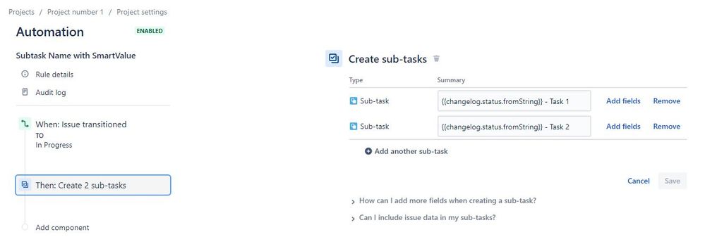

I did some testing on my own and made it work with: {{changelog.status.fromString}}

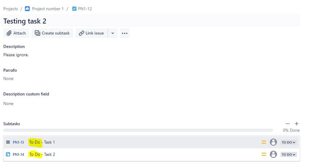

Here are screenshots of the rule I made:
The task in the example transitioned from the To Do status to In Progress, hence subtask with the To Do name were created.
Kindly review and let me know if you have further questions.

@David Freitez Ah this worked! Thank you so much for your help!
