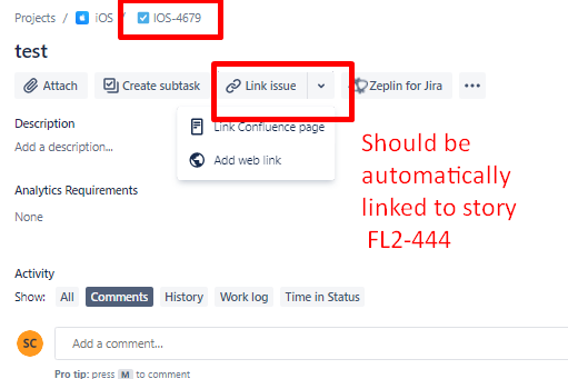

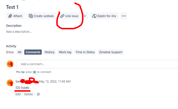

I would like to create an automation rule, so that, when I create a story in my board (FL2), a comment in the story trigger the creation of a task in another board (iOS), but It is also automatically linked to that story.
Story + comment in FL2 board -----> iOS task (in "new state") ----> automatically linked to the story

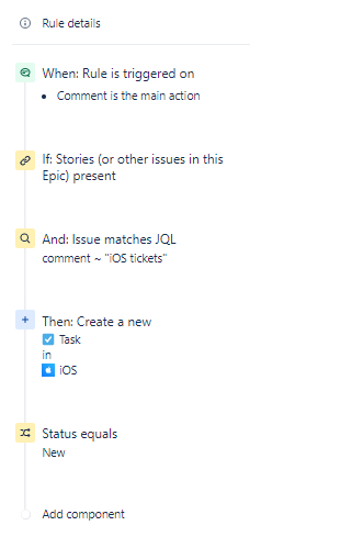

I think that more or less I am able to create the rule till the first part (please, check the picture attached), but then I have no idea how to continue in order to have the task linked to the story.
Could you please help me? :)

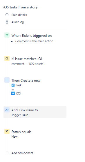

Hi @Sari ,
In Automation for Jira you have the action "Link issues".
With this issue you can link the created issue to the trigger issue.
You can see my automation rule above and then, although I have commented a story, there was no task created in the iOS board linked to the story.
Maybe is It about the order of the conditions set in the rule?

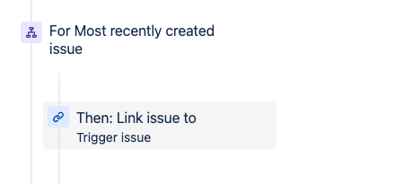

Is the task not created or is the task not linked to the issue?
What's in the audit log? Are there errors in this?
If the link is not made, I recommend adding a branch "For Most recently created issue".

With this additional step I solved the issue! now It works :)
Thank you very much for the help!
