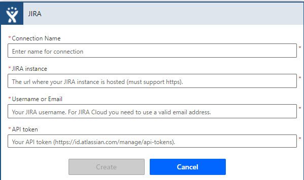

Has anyone been able to create a new issue in JIRA when a SharePoint list is updated or changed?
I am trying to achieve this but need to find information on how to fill out the JIRA data form (see attached). Need assistance on understanding how to complete this in order to use Power Automate to connect the list to JIRA.JIRA data form_use with powerapps.jpg
Dario B
October 23, 2020
Hi @Katie Holmes ,
From what I can see you have to enter the following data:
  1. A name you choose for this connection
  2. Your Jira base URL. For example https://something.atlassian.net
  3. The email address of the a user that you have created for this integration (you can also use the credentials of an already existing user but this is not advised since then you won't be able to distinguish the issues created by the integration from the ones created by the user)
  4. The API Token associated to the user account configured in previous step. For details see: https://confluence.atlassian.com/cloud/api-tokens-938839638.html

We have tried it but, getting below error
Error : Test connection failed. Details: The remote name could not be resolved: 'jiratest.life.pacificlife.net'
I think it's because Jira is internal workflow is public.
So, what will be the solution for the above error?
Thanks,
Dario B
June 29, 2021
@Thorat_ Nikesh ,
Please notice this thread is against Jira Cloud, while you are using a self hosted instance that does not seem to be reachable from the Internet and that's why you get the error.
In order to make this work:
  1. Sharepoint needs to be able to communicate with Jira
  2. Being this on Jira Server, you need to authenticate using username and password instead of email address and api token.

I think @Thorat_ Nikesh wants to know how the integration needs to be set up with username and password authentication instead of email adress and api token as stated in your message from June 29, 2021, @Dario B.
I am currently facing the same challenge in setting up the automation to "Create a new issue in JIRA when an item is added to a SharePoint list".
The error message I receive is: "Unable to get server info response. Status code: 401. Response:"Microsoft.WindowsAzure.ApiManagement.Proxy.Gateway.MessageBody"
Any ideas how I can fix this using Jira Data Center? :)
Greetings
Chris
Chris K
April 18, 2023
Update: The Microsoft power automate connector does not work for jira datacenter: https://confluence.atlassian.com/jirakb/microsoft-power-platform-power-automate-connector-does-not-work-with-jira-datacenter-1167731016.html
We found a solution by creating a custom connector.
