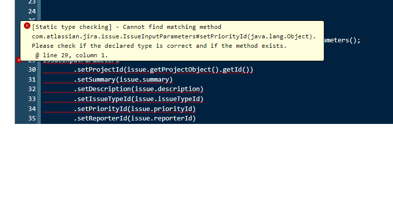

When I try to execute it I get an error. I am unable to figure out what is the mistake here. Can someone please guide?
2 votes
Payne
January 10, 2022
The Issue class does not have a getPriorityId() method, but rather it has a getPriority() method. See https://docs.atlassian.com/software/jira/docs/api/7.2.2/com/atlassian/jira/issue/Issue.html
So instead of issue.priorityId you can use issue.priority.id

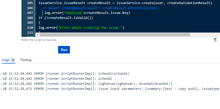

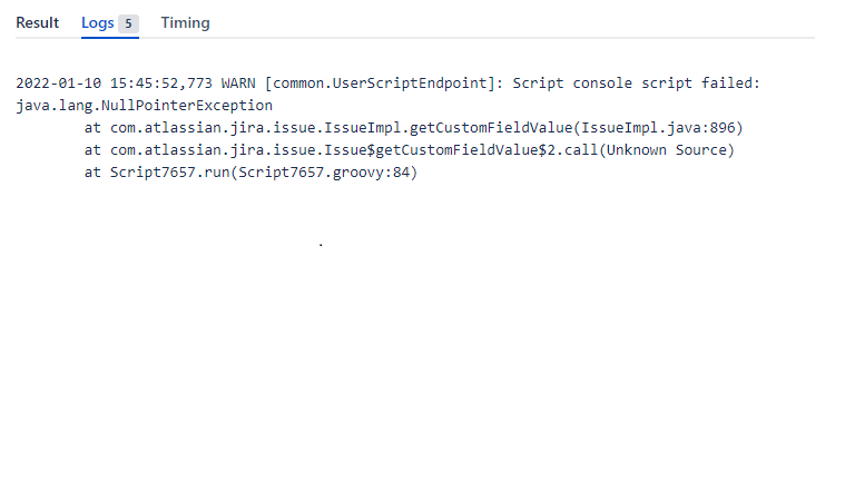

Deleted user
January 10, 2022
I added createResult.issue.key but it isn't working. Is there something that I am missing
Another issue stated appearing when I added all my custom fields is below. Any pointers?
Payne
January 11, 2022
My first guess would be that you're not creating the new issue. I would put the log.error("newIssue"+createResulet.issue.key) line in an else block, i.e.
if (!createResult.isValid())
log.error("Error while creating the issue.")
else
