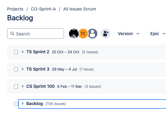

Here is the board.
The filter is project in (CS, TS). The sprints were created in other boards specific to those projects.

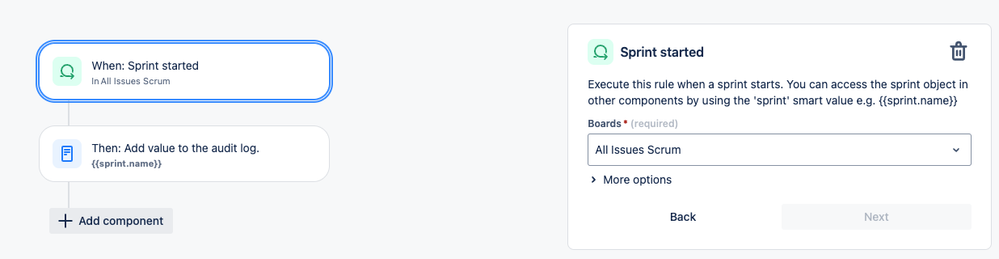

Here is the rule.

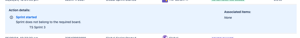

And here is the Audit Log.

Hello @Senthil Kumaran
Automation Rules do include a Sprint Started trigger, but you are required to select the applicable Scrum Board as part of that trigger.
I tested out creating a board that used a filter that pulled in all the issues across all projects where issues might be included in a Sprint. Then I selected that board in the Rule trigger. However, the sprints shown in that board actually belong to other boards. When I started one of those sprints, the rule was triggered but said "No Action Taken" because the sprint didn't belong to the board named in the rule.
I don't believe it is possible to create a single Global rule that will work for any sprint started in any board.
I believe to achieve your requirement you would have to create an automation rule for each Scrum board where Sprints are created.
As part of each rule you could add a Lookup Issues action to get the issues contained in the started sprint, and a Send Email action to send a copy of those results to somebody.
