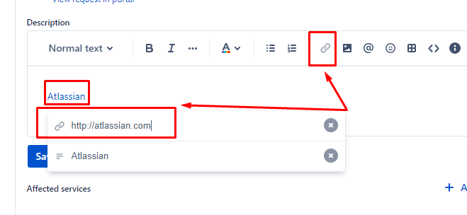

You can't create a custom HTML button on Jira. What you could do it to create a multi line text field (call it URL or whatever), which allows you to link a word/phrase/string to a URL:
Does the above help you?

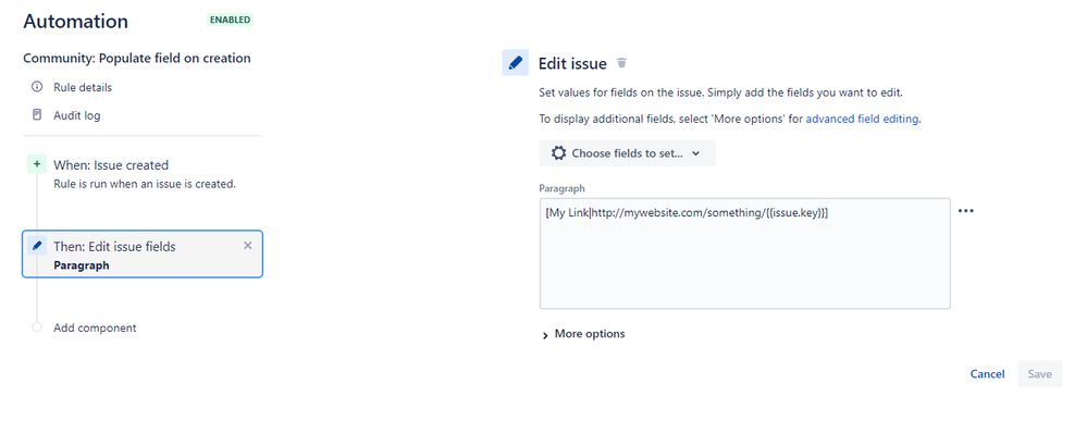

Try the following:

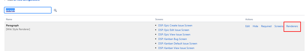

  • Create a multi-line text field (in my example is called "paragraph"
  • Go and edit the field configuration used for the specific project
    • find the "paragraph" field and click "Renderers"
    • Change the renderer to "Wiki Style"
  • Go to your project and create an automation rule
  • Test your rule

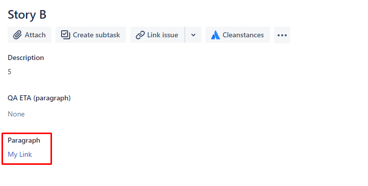

You should have a result like the following:
Hope the above helps! :)
