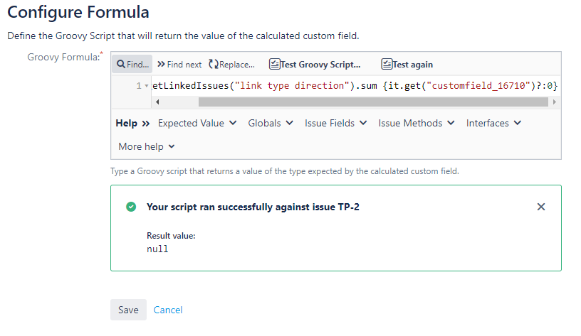

Hi David, Thanks for your answer!
I tried and the script returns no error but even though my fields have values it still returns "null"
I created 3 tasks and completed values in the custom number field i want to sum + have added the epic link but it doesn't seem to sum the value in the calculated field in the epic...
Could it be because of the "link type direction"?
Thanks again for your precious help!
If you have added the Epic Link on the tasks, that means the task belong to the Epic. You therefore need to use the first script I provided.
