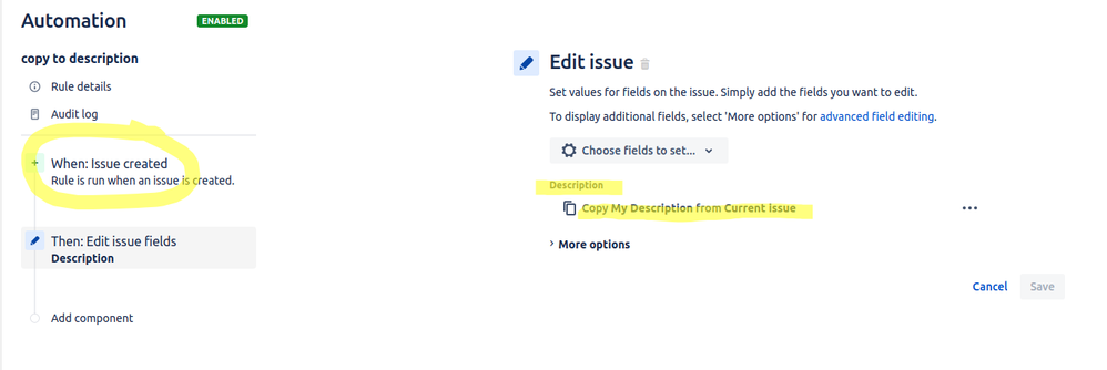

Hi @梁峰 Jeff Liang (Engineering - QA) ok, I just tested it and it really looks like a bug. I will raise a ticket for it. But I also found a workaround.
If you use Automation, it works. I prepared automation like this:
Thanks

Hi Jeff just for your information. Atlassian created bug for not-working Copy field data postfunction: https://jira.atlassian.com/browse/JSWCLOUD-21782?error=login_required&error_description=Login+required&state=6e713adf-5385-49bb-9838-8843a01303da
What about automation workaround? Did it work for you?
it works
Martin Bayer _MoroSystems_ s_r_o__
August 4, 2021
Ok, cool, would you be so nice and accept the answer? It might help other people who will need to copy field value on Create transition.
